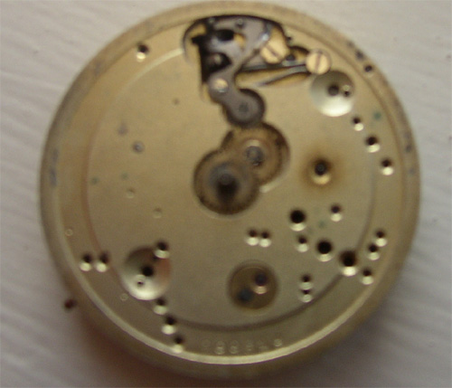

Sort of a "cry for help". So I have this old Ulysse Nardin trench watch, movement I was able to find out what it is with help from someone previously (who also supplied the great pics below), which is a 13 ligne Orion, 15 jewel. It is missing winding pinion/wheel and a third wheel (wheel that meshes with the castle pinion) and lacks stem and a crown that has a larger opening to go over crown tube. I figure stem and crown generically can be found more easily at some point.
I know movement parts can be made from scratch to work, but I was told for each part it would be $150 or more for them to be made. (my jaw dropped) There may be other movements of same size and similar age and layout that I figure might have parts that would work. I've done a "hit or miss" approach on Ebay, paying $10 here and there for trench watches for parts, but the parts have been too big.
Just wondering if anyone may know of some ideas on obtaining such parts. I'd love to have this thing working and wearable.

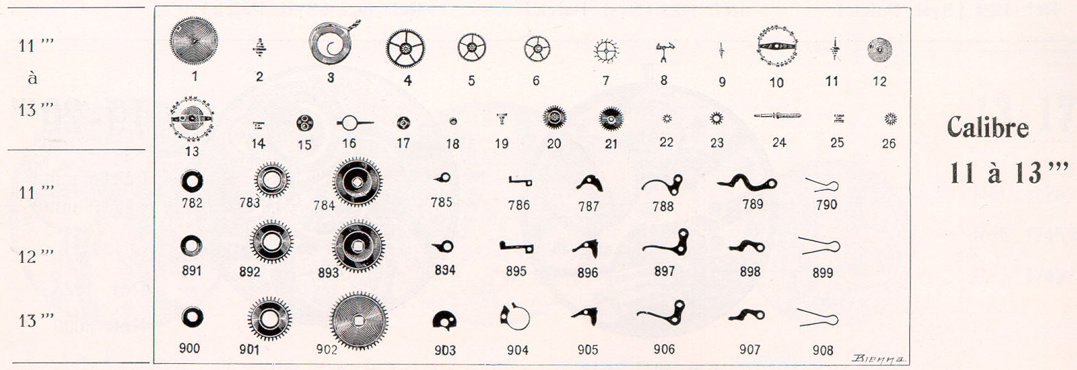

Where did you source the parts illustrations for your watch movement?
John

I had gotten the illustrations for the movement through someone on Time Zone, who had a book that happened to contain them.
Tim

If you can indicate from the parts diagram exactly which parts you're short of, I 'may' be able to help.
I've just dug out a box with a large number of 'hands setting' transmission gears, castle wheels, clutches etc, plus a bucket load of winding wheels and old 'onion' crowns, most of which will clean up ok.
They've all been removed from Swiss wristwatches of a similar vintage to yours.
I also have about half a dozen incomplete 12.5 - 13 ligne movements which I may rob if something is suitable.
If one of the wheels is missing from the transmission train on the dial plate (appears to be), let me know the diameter of the boss on which it operates, approx height of the gear, plus the radius from the centre of the boss to the root of the gear teeth it meshes with.
You may have to do some fiddling around with the bits to make fit, but better than nothing.

Thank you both! John, if I see things correctly in diagram, I'm missing parts: 22 and 26
Smallest wheel (#22) in the transmission train, one that meshes with the castle wheel. The other missing (#26) being the winding wheel.
I don't have any calipers for measuring, but I can provide a rough measurement as you've requested.
I figured as well, that there must be parts from other manufacturers that would essentially work/fit, but a matter of finding right size and # of teeth.
Tim
