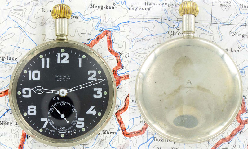

Francesco Marco MaraschinHere is a picture I found on the internet.
The caption: "Zenith 1917 Cockpit Watch, Now in Zenith Museum (source: Military Watch Forum – James Dowling)"
And here is a very similar watch with very close matching serial numbers
http://www.mwrforum.net/forums/showthread.php?t=27292April 06, 2013, 09:11
Martin CookRe the luminous dial watch - I haven't seen SWISS MADE on a Zenith Mark V dial before, the font used for the C.B. code is a variant and the luminous dots haven't been improvised as they usually are. Looks characteristic of a MOD redial to me. Plus it hasn't got an issue number so had probably not seen service (as a luminous watch anyway) - a stores item? It shows that Zenith probably
supplied Mark V cases without a bow but doesn't solve whether they were ever
issued in that state?
Martin
