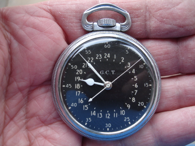

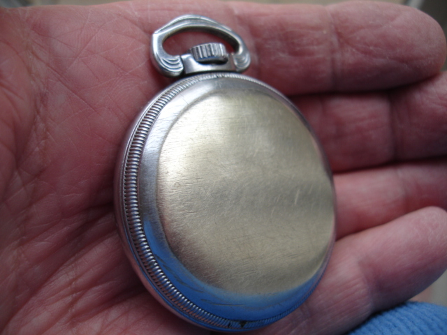

Hi folks from the UK.
I have recently purchased a 1941 4992B and unfortunately, it seems some previous owner has sanded out the original letters / serial numbers on the back cover.
The watch has been serviced by our great chap Roger Nolfe and is superb.
Would any member have another back cover to sell or, what do people think about having it re-engraved with as near a serial number etc to correspond with the date serial numbers?.....
A great club.......Steve.
April 27, 2018, 14:08
Stephen John Ward
The back cover.

Jim Hester
Re-engraving the back with the appropriate data would be a bad idea in that it could never be done properly such as the exact size and spacing of every number and letter. And even if you could get someone to get it close, you would not have the correct data for the serial numbers. In either case, a knowledgeable collector may balk at buying it as either a faked case or a marriage should you ever wish to sell it in future. You could leave it as it is, or try to find a donor watch with a trashed movement but decent case, or even a case that has lost its movement at some point. That may not be easy and it would not be the right case for your specific movement since the numbers would not match, but it would at least look more correct to a casual glance than the one you have. By the way, sometimes the military markings on these were removed deliberately by someone who either 'nicked' the watch from the Army Air Force or who came by it legitimately as surplus but who did not want any questions asked about how they came to own a piece of government property. If it were mine and I wanted to have a proper example of this nice watch I would leave it as it and sell it for what I could get for it then buy a completely correct example to have in my collection.
April 29, 2018, 04:51
I agree with and fully endorse Jim's comments directly above.
My initial thought of exploring or even considering a re-engraving of that case would NOT be wise or prudent. There are far too many faked-up watches out there already. This is particularly true of 4992B examples as thousands were sold off as "Army-Navy Surplus" and many of those worked-over with altered to 12-hour gearing and re-dialed as beginner-projects in watchmaking schools. In collecting these I have come across quite a number of mixed-up case components or movements re-cased incorrectly.
In fact it seems that all too often when an altered messed-up watch surfaces the "anything for a buck" seller almost invariably makes an outlandish claim like "rare and valuable" or "one of a kind" or "prototype" when it is nothing of the kind.

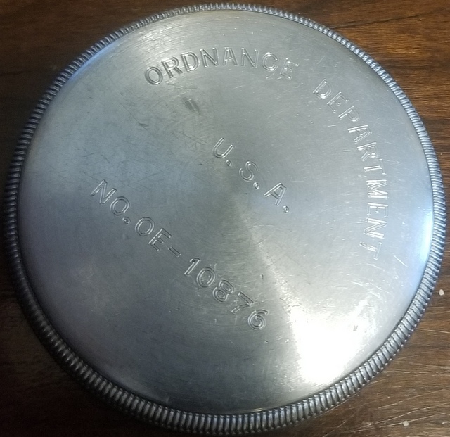

I just saw this.
I have a back cover, but don't know if it is correct for that movement.

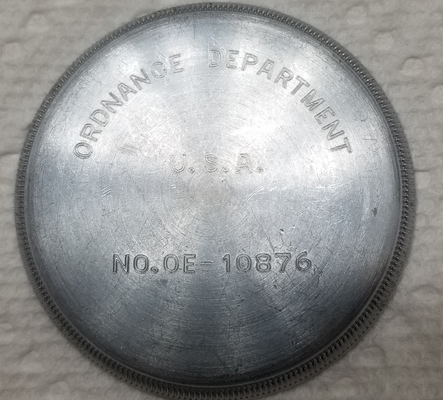

Larry Lamphier
Another picture

April 30, 2018, 09:58
Buster Beck
That's not the correct back for the Hamilton 4992B, just so y'all know.

Jim Hester
Buster is correct. That is not a correct case back for a 4992B. Here is another thread with some good photos of 4992B's with some correct case backs.
https://ihc185.infopop.cc/eve/f.../p/2/xsl/print_topic
The case back being offered is a very nice military case back but it is for an entirely different kind of timepiece - one that would have been used by the U.S. Army. Here are the U.S. Army Ordinance Department codes for Army watches from that time period. You can see the OE code here and that it should go on a U.S. Army 21 jewel railroad grade pocket watch.
