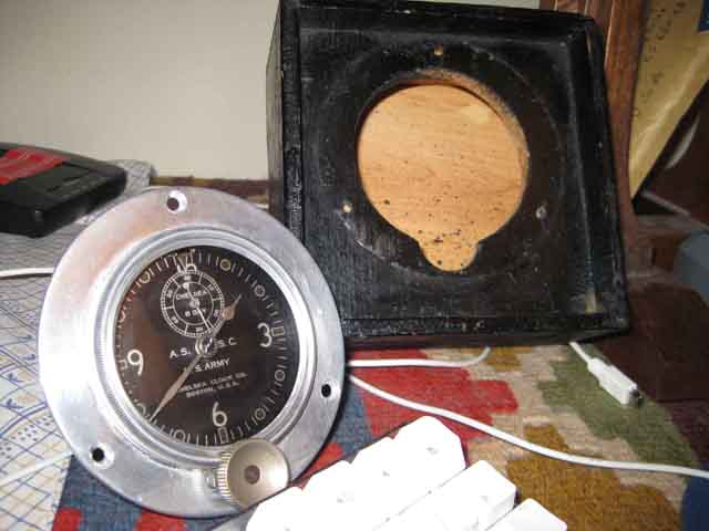

Ronald D. Canaday
Hi Mark,
Based on your description, I believe my example may be a brother to yours.
On the dial:
A.S.S.C.
U.S. Army
Chelsea Clock Co.
Boston, U.S.A
On the back of the ALUMINUM case, it is marked..
C.C. Co.
146
January 1918
And on the back of the small housing that encloses the winding gears:
114125
-(this same 6-digit serial number matches the number stamped into a plate of the brass movement).
By the way, mine was still mounted into a wooden Chelsea shipping box, leading me to believe it was never issued. Although some latter day genius painted the box with black gloss enamel, the impressed letters can still be read on the box:
From Chelsea Clock Co Boston Mass U. S. A. -then a 3-digit number that is too distorted to read- From
Chelsea Clock Co
Boston Mass
U. S. A.
Ron

Mark Bean
Indeed our clocks are brothers. Yours is really a beautiful example of the family while mine has been treated somewhat like a stepchild.
Can you tell me if the bezel is a two piece one? It looks like maybe the glass in sandwiched between two bezel rings, but I'm not sure.
A friend is going to lend me a strap wrench to try that is actually designed to remove small oil filters . It's got a rubber strap that ratchets tight before you unscrew the filter. At least it should not damage the knurling, but, since it will have a relatively small thickness to grab onto, I don't know if it can do the job. I'll let you all know.
Thanks for the great pictiure of your clock!

Ronald D. Canaday
Hi Mark,
Your analysis of the bezel assembly is correct.
-After removing the winding knob, the silver bezel unscrews. Looking at the inside, there is a brass ring which appears to be holding the glass. The brass is a little less than 1/16 inch thick, and it appears to be a machined part.
-To release the glass, the brass piece must unscrew (but I see no good way to grip the brass, it sits almost flush with the rear of the silver bezel).
Ron
