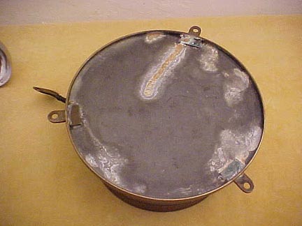

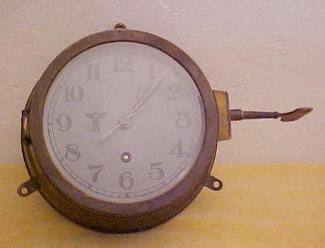

Any opinions. I am confused. Does a serial number on the face mean it was on a Uboat
Mine does not have a serial number on the face.
The corrosion on the back looks like it was from salt water.

Hi Perry, welcome to the forum.
Is the dial on your clock silvered metal, painted metal, or paper? It's hard to tell from the images.

I asked to inspect the clock before purchasing the clock. You asked: Is the dial on your clock silvered metal, painted metal, or paper? It's hard to tell from the images.
I asked the seller your question and the deal fell through. The seller backed out.
I think it looked like a paited dial or a paper overlay.
What do you think Greg.
July 19, 2006, 11:55
Jim Hester
It sounds like there may have been something "not right" about the clock since the seller backed out when you started asking the appropriate questions. Greg's point about the dial is a good one, and for a clock that has so much wear and damage on every other part, the dial looks terribly out of place. There isn't even any of the usual wear on the dial around the winding stem where the key would have been inserted repeatedly to wind it up. You would expect to see a circular pattern of scratches and wear heaviest next to the edge of the hole and fading out as you move away from the opening where the key would have been rubbing as the person who wound it up would have taken a moment to move the key around slightly to line it up on the stem.
July 19, 2006, 17:34
Greg Crockett
Jim has cinched it. The condition of the dial does not match-up at all.
Another point, I don't think I have ever seen one of these with an original paper dial.
Best regards,
Greg

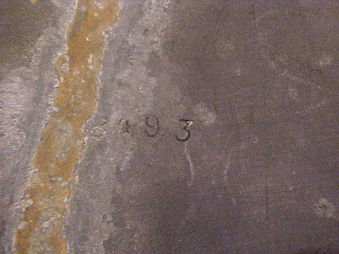

I finally got my hands on a German Uboat Clock.
movements number is
16739
The dial has a number 15963. The sticker on the back says Kienninger
> Obergfell 15963 N 39
> It appears to be written many years ago at the KM Clock shop.
September 03, 2006, 22:59
Perry Vermillion
The back.
Can everyone give an opinion.
The clock on the locking block also has stamped 39.
Any guess on the year or where to research the dial number?
Have at it because I am just a collector.

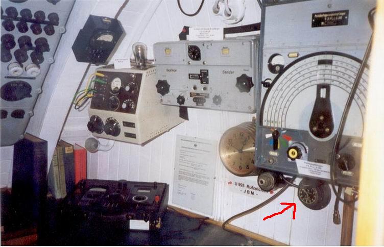

I ran across this photo of a U-boat radio operators console.
I heard the Uboats had 5 big clock.
Notice the small Junghans J30E with a 3 inch dial.

Thanks Ged. I appriciate the assistance on the sweep hand, I must remember to check first and then type. Confused
Interesting; Two clocks for the u-boat radio room; one for local time and the other for German time?
A bit of u-boat trivia, examples are known of u-boat radio rooms fitted with captured French aircraft clocks.
