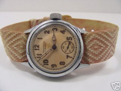

While browsing eBay I found this military wristwatch that I thought looked cool.
As a newbie wristwatch collector who also knows very little about military watches, I'd appreciate any comments about whether this watch is worthwhile, things to look out for, etc.
The same seller has quite a few other similar watches listed:
Click here to view seller's other items
Is there anything on that list that a new military WW collector should particularly want to go after?
This seller also has a couple of watches like this one, except they have what is said to be a NOS Waltham dial, except it is unsigned, and of course he wants more for those.
From a collector's standpoint, I think I would prefer an original signed dial like this one, even if it does have a few freckles.
I also have a couple of questions:
1) Were the hands and dials originally treated with radium on these watches?
2) What about the band/strap, is that original?
Auction Image
January 04, 2006, 14:28
Greg Crockett
1) Were the hands and dials originally treated with radium on these (Ord Dept.) watches?
YES. Most of them had radium. One way we can see the dial on the above watch is original is the radium burn mark from the hands being left in one position over a long period of time.
NO. It is an old commercial strap, it may be as old as the watch but it is not military. Issue straps were O.D. green or tan cloth. Walthams originally came with two part straps. Elgins often had a one part strap w/an Elgin marked buckle.

Regarding original dial w/name - I agree they are the way to go.

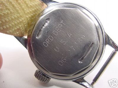

The Waltham Ord. Watch pictured has a problem with the case back. For some reason, I see what looks like two shallow holes drilled into the back. Otherwise, it is a nice case.

Speaking as a mechanical engineer, those holes drilled in the back cover look to me like they were meant to fit a particular spanner wrench someone had so he could get the case back open without having the proper type wrench to get a grip on the flats along the rim.
Another watch on this seller's list has also been modified to fit a different improper spanner.

1) Whenever someone says a watch has been serviced and you are seriously considering buying it, you should always ask for the details on what they mean. If they mean a professional watchmaker took it apart, piece by piece, cleaned each piece, replaced all worn or damaged parts, reassembled it, and adjusted it to keep perfect time, then that is a huge distinction from either removing the back and spritzing the movement with a bit of WD40 or even removing the movement and dunking it in an ultrasound cleaner for a while. Those kinds of servicing should be considered detrimental and subtract value while the former is desireable and adds value. If the gouges in the metal on the back occured during this recent "servicing" my guess from the crude and destructive routing is that the "servicing" was more than likely done by an amateur and should be considered to be a big detriment to value. No professional watchmaker I have ever run across would not have such basic tools on their bench as the assortment of back openers that would include one to fit a watch like this one.
