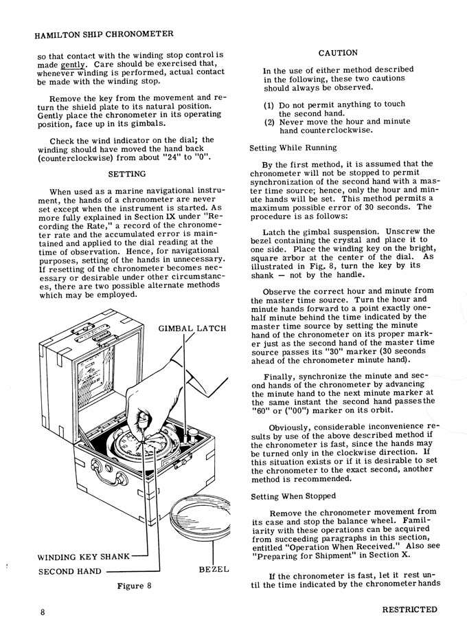

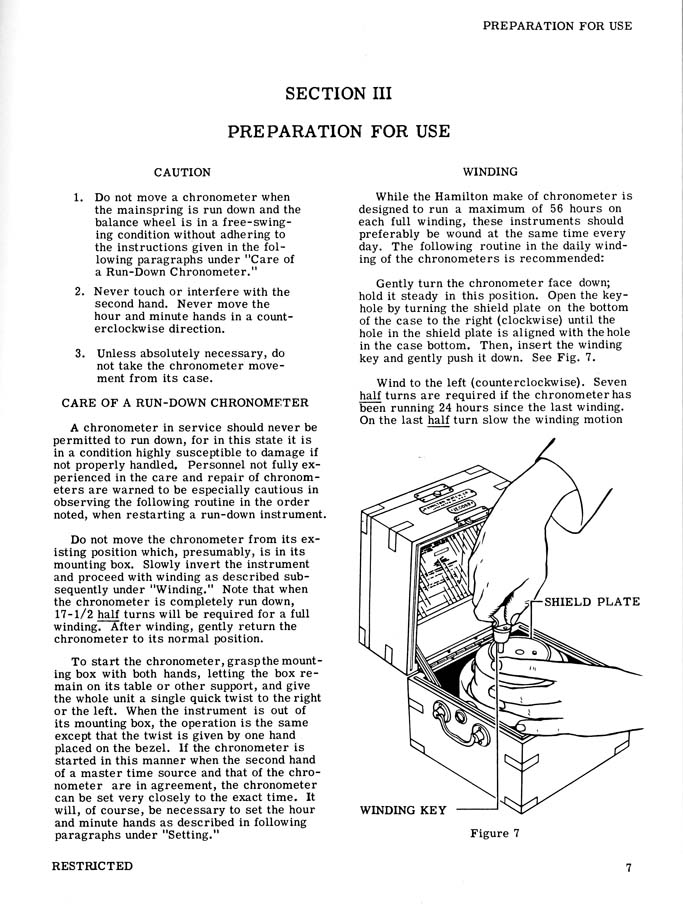

Robert McClellandHere are a few pages from NAVSHIPS 250-624 that show the winding and setting of the 21
October 10, 2013, 03:54
Robert McClellandNext page

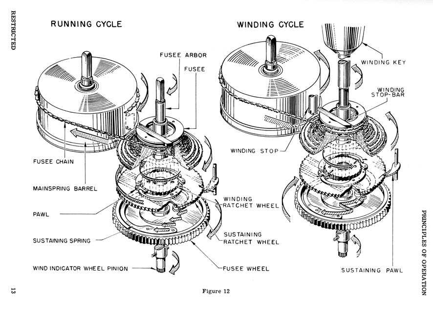

Robert McClellandRunning & winding cycles

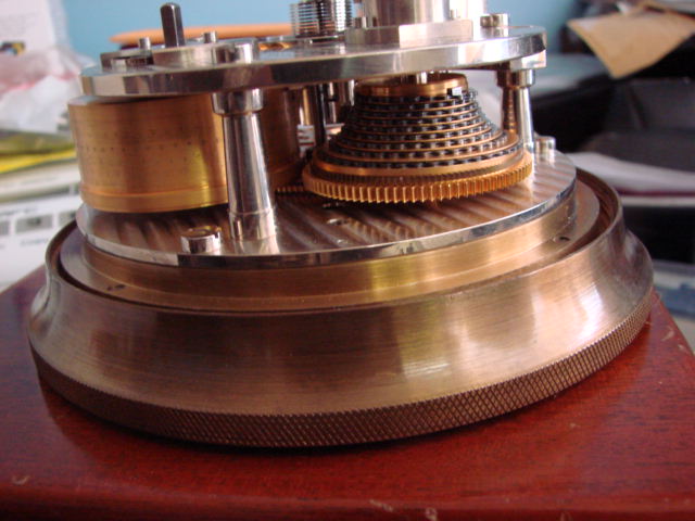

Paul ReganTom, is the fusee chain on the barrel or on the fusee?  There is a wind stop that comes into play when the fusee chain passes over it.  You can see this in the previous description.  If the chronometer has not been cleaned in a long time then this bar could be stuck in the lock position.
Paul
November 03, 2013, 11:21
Tom Bruntonhi Paul; the chain is on the fusee as shown in photo,and the key works in reverse only,seems locked out in wind mode,??? The movement appears not to be taking power from the fusee,or the fusee is not getting power from the spring drum,Tom
November 03, 2013, 13:56
Robert McClellandTom, from your photo it doesn't look like the fusee chain is attached to the spring barrel. It should look like it does in figure 12 above. I will post a few more pages from the NAVSHIPS manual on the reassembly of the fusee and barrel when I get a chance to scan them.
November 03, 2013, 14:30
Tom Bruntonexcellent eyesight and understanding of the problem,Robert. On closer examination that is exactly the state of affairs with the fusee chain ,it is not attached to the spring drum !!!
 and I don't know how to re-attach it!!!
November 03, 2013, 14:53
Tom BruntonSO I'M GUESSING THE FUSEE IS WOUND FULLY UP BUT SINCE THE CHAIN WAS NOT ATTACHED ,THE SPRING DRUM IS FULLY UNWOUND ????

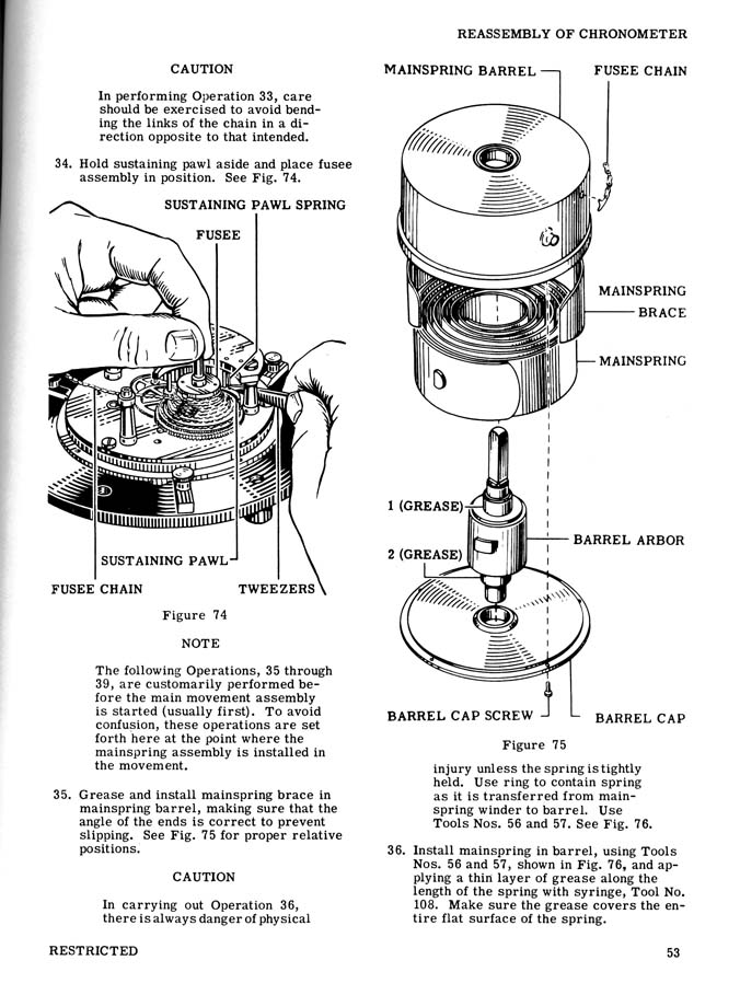

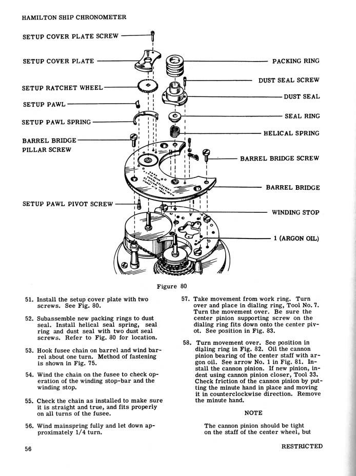

Robert McClellandTom, here is a page from NAVSHIPS 250-624 that shows how the chain is attached to the barrel (fig 75)
November 03, 2013, 15:18
Robert McClellandAnd here is another that shows the sequence for the initial winding ,steps 53 through 56. I assume that when it says to wind the mainspring in step 56 that it is done by winding the mainspring barrel arbor not the one on the fusee. Hopefully someone who has actually done this will comment if that's not correct!
November 03, 2013, 15:40
Robert McClellandHere is a little more info from an article that Doug Sinclair did on servicing the Model 21:
"The proper way to set up the mainspring on these chronometers is to wind all of the fusee chain around the fusee
except for about 3 inches and then to position the fusee in the movement. The mainspring barrel is then fitted, and the
other end of the chain is hooked to the barrel. At this point, the mainspring is completely run down. The barrel bridge
and ancillary parts are then assembled, the balance wheel and cock are fitted, and then the mainspring is fully wound,
after which it is let down by the method shown earlier, about a quarter of a turn. During normal operation of the
chronometer, winding actually occurs at the arbor on the fusee, not at the barrel arbor."
