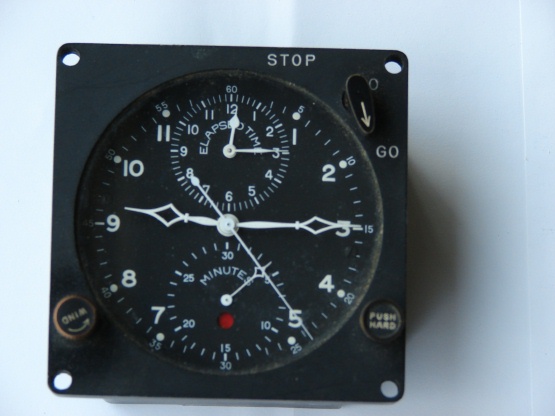

The name Wakmann can be found on various fine timepieces, including wrist and pocket chronographs.
This example is a USAF Elapsed Time aircraft clock.  It's a rather high grade item.  The Wakmann commercial sales list from 1966-67 lists elapsed time clocks at $400.00 and up.
Looking through the pages of MILITARY TIMEPIECES by Whitney, there are a number of Wakmann models shown, including a "Radar Shelter Wall Clock" and a less expensive aircraft model with two dummy elapsed time hands.  A rather interesting line of timepieces.

This thread has reminded me that I have a Wakmann 8 day clock out of a C152 (Cessna).
The mainspring had let go and took out the escape wheel and pallet staff pivots.
Anyone any idea where I can get a mainspring for this thing? (I'll certainly have to make new staffs to repair the other damage)!
This thing was given to me as a junker to play with, (by a flying school I worked for as an instructor), and has been stripped down for years and remained untouched because of a lack of spares availability.
I've googled all over the web at various times and contacted every horological supplier I know of in the UK (including one which makes mainsprings) but no joy, they simply don't have Wakmann in their catalogues.
It could explain why very few Cessna club aircraft in the UK have working panel clocks anymore I suppose!
Are bits available for Wakmann in the USA??
