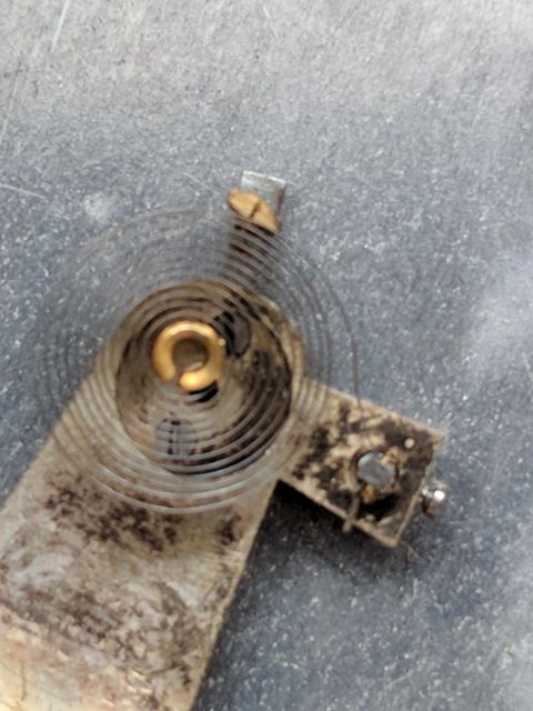

posted
It looks like this one has not been serviced since the Great War. Powered by a rather common Swiss pocket watch movement at least some parts are obtainable. A dry broken main spring and many other issues......

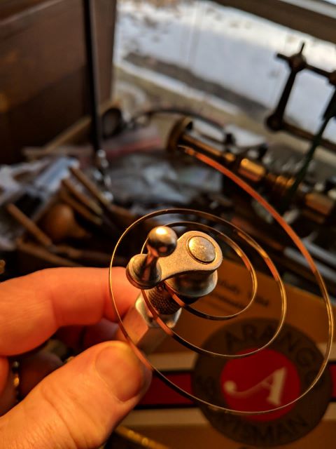

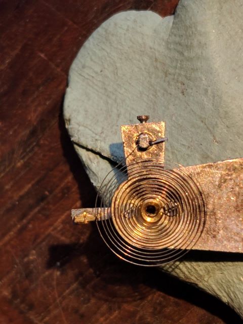

posted
The hairspring must be adjusted.

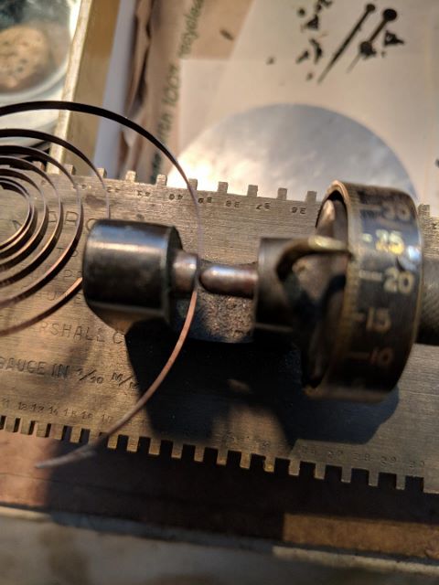

posted
Double checking the strength of the replacement mainspring.

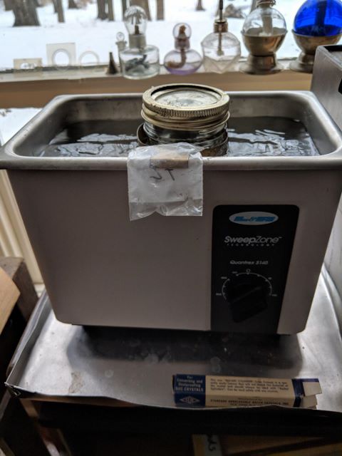

posted
everything into the cleaning machine......

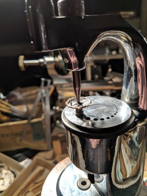

posted
Assemble the balance and adjust the beat......

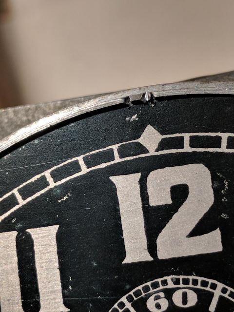

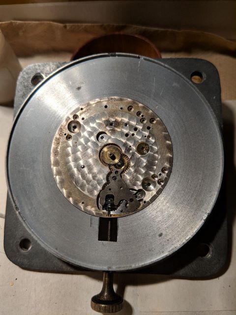

posted
At the factory, the dial was attached to the case by three double strikes, staking it in place. This is how I could tell that it had not been taken apart since it was first built. Because the movement could not be removed without taking off the dial. So, now it is reattached by re-staking it as close as possible to the original stake marks.

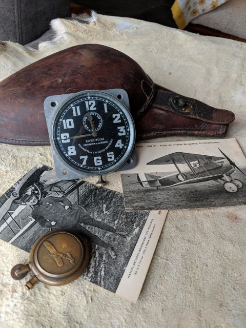

posted
Now it's back to life ticking happily and keeping time. Ready to re-install in a Spad perhaps? Or more likely hanging out on my desk.

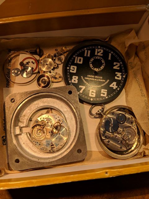

posted
Very nice job, Greg! It is great to see one of these brought back to life. My Favre-Bulle is a bit different in that I have a DOXA movement in mine. The couple of other Great War Favre-Bulle cockpit clocks that I have seen also had DOXA marked movements in theirs. I am not seeing a maker's marking on yours, is there one? Is it possible that yours has a regular pocket watch replacement movement or perhaps Favre-Bulle used different manufacturer movements? I don't know but I would appreciate hearing your thoughts on these.

posted
Hi Jim.
Sorry for the confusion, I did not bother to post images of the front and back of the completed movement. It is in fact a Doxa movement and marked as such, the same as your clock and the same as my other Bulle aircraft clock. I have worked on a few of these and it looks like Doxa was the only movement Bulle was using.
