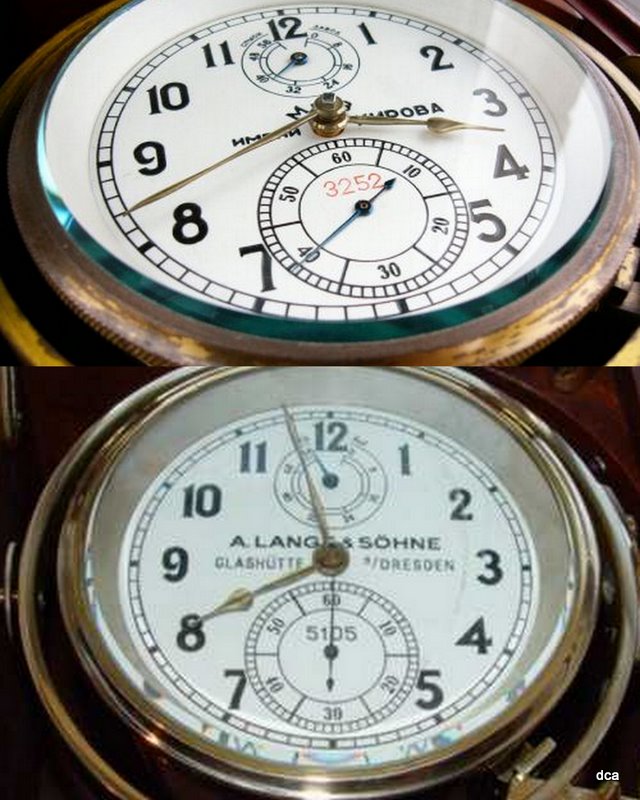

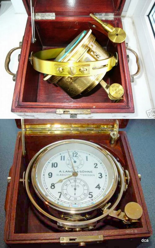

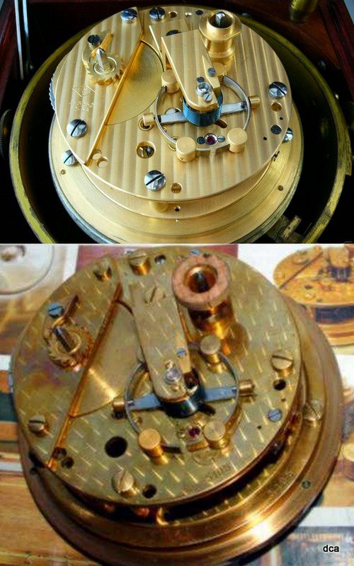

David AbbeWerner, Michael, we are talking words and maybe you can clarify this a little more with a set of comparative pictures I put togethewr with My PolJot and the "Other" Chronometer recently sold on eBay. I see slight differentces in the wooden case details and fitment . . .
March 07, 2012, 23:07
David AbbeThe Dial Arabic font, Hands, Crystal and Bezel are identical . . .
March 07, 2012, 23:11
David AbbeThe movements have slightly different damaskeening, but take the cork off the winding shaft and I see no difference . . .
