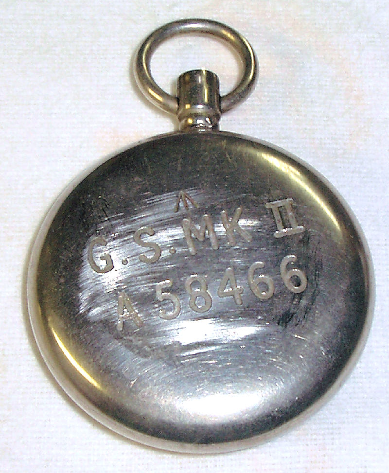

GS MKII - A58466 Below Broad Arrow.
My Rolex is GS MKII - A20498
Would be interesting to compile a database of GS serials and see how close the numbers get and with which brands!
John
GS MKII Caseback

July 06, 2007, 09:24
Greg Crockett
Nice pics, John. Thank you.
I must agree, it would be a good idea to start a data base of MK II and GSTP watches.
Regarding the above watch, the movement looks to be of higher quality than most.

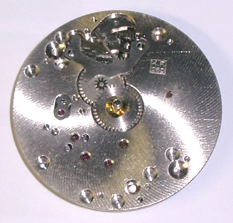

I decided to delve a bit deeper into the watch this morning and find out a little more about it.
Having stripped the movement, found it is actually in great shape (if you discount a broken mainspring, seconds pivot and missing stem/crown ect), should be a fairly easy fix.
The crunch on the winding gear was nothing more than a broken mainspring and the winding wheel rubbing over the ratchet wheel - due to the setting lever being in hands setting postion, allowing the ratchet wheel to tilt over.
Your first impression of the movement was the same as mine Greg, in that it appeared a cut above average, which I put down to it being so clean.
That is, until I found a capital 'H' stamped into the dial plate, which made me immediately think 'Helvetia' (General Watch Co).
Took a look in my Bestfit books and found that Helvetia do use the 'H', but enclose the initial in an octagon - this letter was open.
Browsing for a 'KF' trademark on a hunch, (movement is Cal KF260), found that the manufacturer 'Kurth' used the trademark initials 'KF' in a box and, that a Cal KF260 movement was listed by them - Bingo!.
Going to the movement ID page for that Cal, the setting levers were an exact match to this watch which confirmed it.
So, looks like either a Kurth KF260 ebauche supplied to Helvetia, or a Helvetia (General) ebauche supplied to Kurth, not sure which is most probable.
Looks like a much better watch than I first suspected.
BTW Kurth is also Certina.
Nearly forgot, the dial is held by two screws into the side of the dial plate!
