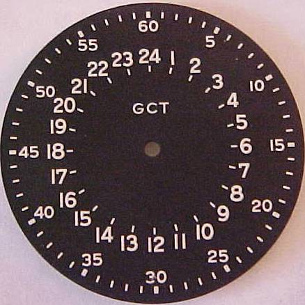

Would like some opinions on whether this dial is original or reproduction? Most I have seen have periods next to each letter in GCT.

On page 331 of MILITARY TIMEPIECES by Whitney, there is a 4992B with a dial exactly like the one in your post. The alternative font used for the letters GCT (without dots) is also the same as your dial. Other than the picture, there are no comments in the book regarding the slight variation you have brought to our attention.
The dial appears to be a less common 4992B dial variation, but that alone does not make it a fake. If I needed the dial - and the price was right - I would buy it.

Terry HillThank you Greg... I would believe Whitney to be a crediable research source...
It is interesting to know there are variations here also... but not surprising as production extended for a significant time frame...

Looks like a candidate for a low ball bid.
