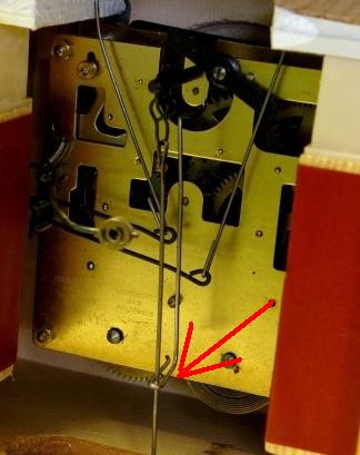

When working on cuckoo clocks I've often heard a squeak that coincides with the pendulum swing and I've never been able to to find it. It seems like a little oil would take care of it but it doesn't. Any suggestions?

Try a drop of vicous oil at the point I marked on the picture (where the fork or needle eye meets the pendulum rod).
Regards Gerald
