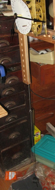

(An easy way to get real close is by using circular magnets in place of the bob. stack a few together until you have something that is about the same weight as the bob. Then clamp the end of the rod between them. They are easy to adjust, and will get you close enough that you should be able to make any necessary adjustment by raising or lowering the chops. (While magnetism is a big "no-no" with balance movements, it really has little effect on most pendulum movements, except the most accurate of regulators.)
Here is a photo of a Seth Thomas #41 movement I was messing about with, trying to create a long pendulum, to make the clock run at half speed. They are a little out of focus, but you can see the stack of magnets on the bottom rod, near the floor. (Incidentally, those pendulum rods are old bicycle spokes. I heated the ends with a propane torch, and bent each one around a piece of 1/4" round stock to create links.)
