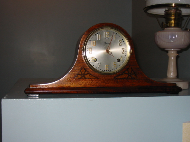

I just finished putting my first coat of tung oil on my clock and if it is dry enough tommorow i will buff up with 0000 steel wool and put second coat on.
Are 2 coats sufficient to put on ?
I will post pics so all can see how it looks after.

Kevin PestorI finished my sessions mantle clock today and it looks really good, i got lots of good advice from a member of this chapter.

Tom SeymourVery nice job!! You've got a great looking clock. Did you work on the movement also?
