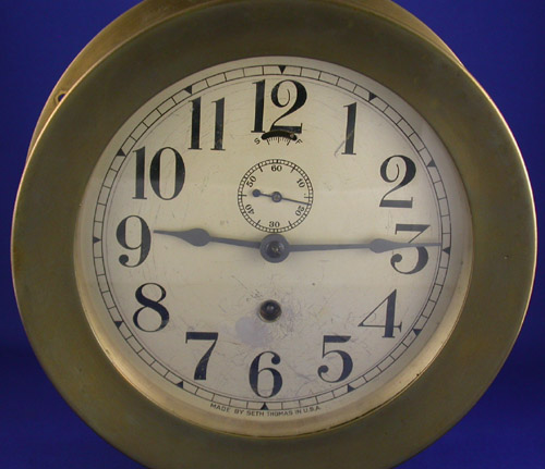

Could somebody give me some tips on how to polish a Seth Thomas brass locomotive clock case.

Peter KaszubskiBrasso will help but Mike H did some great restoration on those perhaps he will chirp in.

There are a lot of things you could use, but my vote goes to Maas polishing crème.

Maas is great but a bit on the expensive side. I use Blue Magic Metal Polish Cream, you should be able to find it at an automotive store and it works great.

The Air Force chief of Staff uses Flitz on his highly polished Aircraft(speckled trout) I use it on my aircraft as well

Norman MayberryI've used Mother's Mag and Aluminum polish for years.It's non abrasive and can be used to polish just about any thing.Bikers use it on their Harleys,I use it on pocket watch cases,gold , nickel and silver.Available in most Auto parts stores.Regards.Norm

Larry BuchanThank you everybody for the good tips, I have some Flitz and I will give it a try.

Mike HodgeIf the lacquer is off and you are down to solid brass then any good polish works.  Taking lacquer off requires work as well as method.
I've used Brasso and Never Dull.
