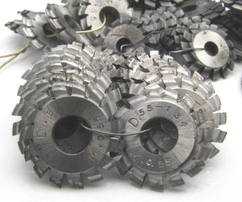

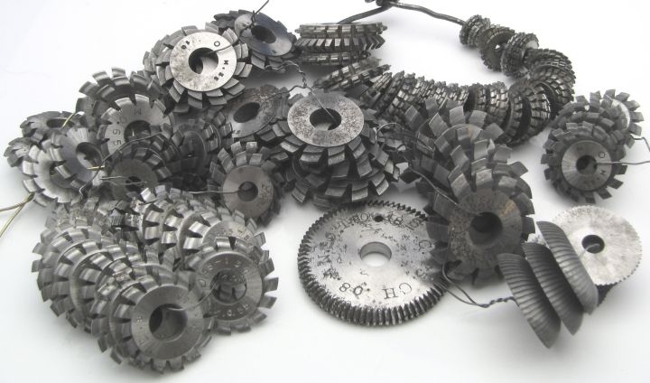

Just picked up a large quantity of gear cutters, plus attachments, milling head and not show but a set also for WW & PW gears. Never had cause to use these yet and a lot appear to be clock sizes. I see a they are marked from 0.55 M, 0.65m, 0,75M 0.85, & 0.95M, also marked are things like D9X, D1218X etc,
The thick wire set are marked with 3 & numbers, also where do the button type cutter used.
Can anyone explain the sizing etc.

John WoolseyChris, you've got an absolute small fortune there in cutters!
The numbers such as '0.55M' and '0.65M' etc refer to the 'Module' of the teeth to be cut.
Rather than try to kill my brain explaining this, the following link will make things a bit clearer
http://www.geocities.com/mvhw/gearing8.htmlThe 'Button' type cutters you mention, would appear to be for cutting 'Recoil' type escape wheels as fitted to longcase and Fusee wall & Bracket clock movements etc.
If you're getting into gear cutting, I would strongly recommend you get hold of a copy of Malcolm J.Wild's edition of 'Wheel & Pinion Cutting in Horology'
http://www.amazon.com/Wheel-Pinion-Cutting-Horology-Historical/dp/1861262450A superb book by a superb horologist, and highly recommended.

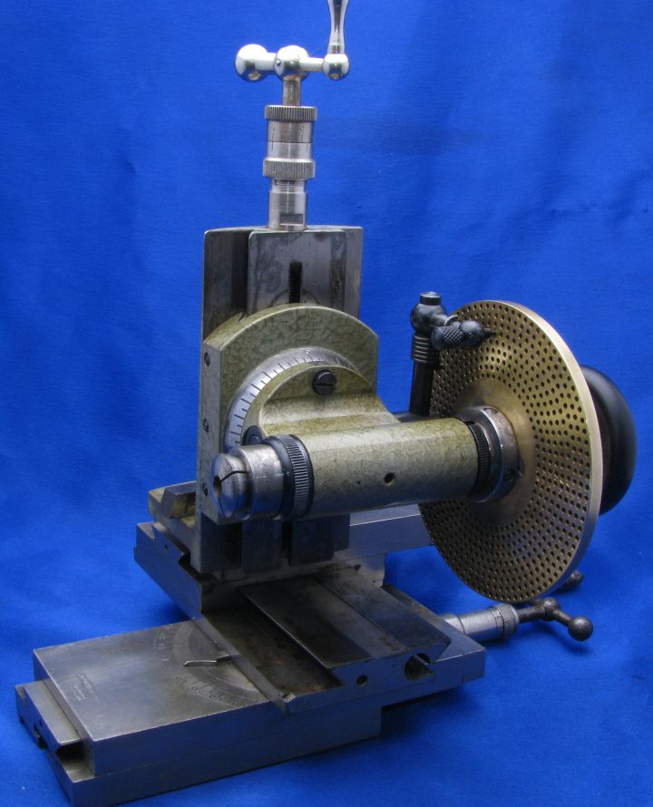

The head looks good also, no doubt need more index plates, if I had a pulley could make the mill work also, more things to find
as is I take the gear to the cutter.

Enzo LiguoriChris,
the M (module) you listed seem to me rather for clocks than for pocket', maybe the small cutters in the background are Modules for pinions and wheels for pocket (and wrist) watches...
You did good to buy them....I wish I would have same luck...congrats !

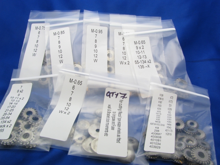

Chris AbellHere is a list I have just sorted them out in to groups, maybe someone can identify the to odd ball K & number ones at the bottom of list,
Also a photo of the small set with what I take to be pocket or wrist watch cutters
not a bad start to my gear cutting set up.

Clive Driscollp.s the small numbers (in brackets) i.e module .55 (6) are for pinions. For pinions you need a seperate cutter for each pinion if the number of leaves are different.
For example to cut a six leaf pinion .55 module you need one cutter, For a seven leaf pinion .55 module you need another.
Unlike a clock wheel where you can usually get away with one cutter for a range of teeth.

I have seen the mill head go for about $600 alone without a index, but I need a drive pulley, no doubt I could make one of those I also have a Unimat 3 that I could turn it on.

As to the dividing head this can be used to hold the wheel blank on a stub arbor. The cutter can be held in a stub arbour in the lathe.

Chris AbellThanks Clive, Seems like the odd ball cutters would be for smaller clocks so have a pretty comprehensive set, not to mention the red box set so another good set of tools to have, also picked up a very interesting jewelling set will post later on for fun by Swatchild.

Hubert F. HockmullerOh! I forgot to comment on your Boley dividing head it is a very nice tool and a, must have, if you want to cut gears. I have one to match yours plus the Lathe and a complete box of goodies to go with it.
I'll put this on my site someday so more folks can enjoy these tools and accessories.
