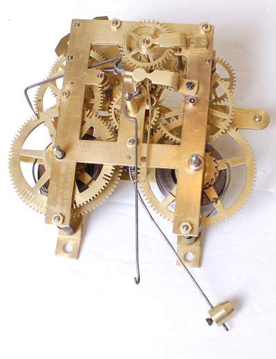

If your clock is similar to this one, it give a pretty good picture of what the suspension spring (wire) looks like. Welch clock movement
Scroll down to the first picture on the right. Not sure where you could buy one of these, but looks fairly easy to fabricate.

Is this it?

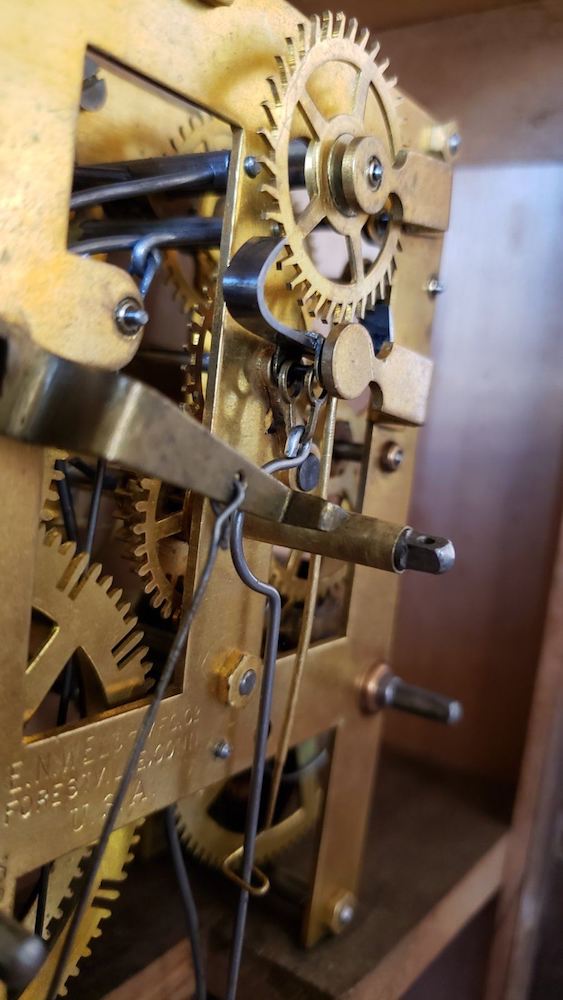

Sounds like you have this type verge.
verge assembly And if so that part slides on a post protruding from the frame. and the same post would accommodate a u shaped saddle spring wire which carries the leader down to the pendulum. Wish I could find a picture but so far have only seen one or two examples on ebay. But they don't show it in detail.
And I am speculating some as I've never seen a clock with this type mechanism.

Pretty good picture here. Might try these folks.
Welch clock

Here's a pretty good picture!
Dave Turner
July 25, 2019, 20:09
Allison Warren
Hi Dave , thanks for the nice picture, I should be able to make a suspension from the image. It is strange I also found the same picture and was going to post it, but you beat me to the draw.
Thanks Allison
July 30, 2019, 10:50
Allison Warren
Hi Dave, I was able to make a suspension from the picture I had to change the scale as the picture was larger than the works. It has been running several days, now I have to make it keep time, as I also do not have the pendulum. that belongs to the clock .

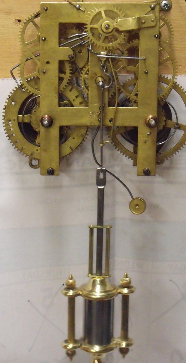

Allison Warren
Here is a picture of my clock
Allison
