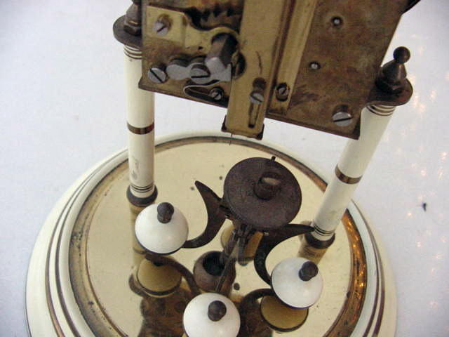

Samie L. SmithHello everone you fellas were right about the suspension spring i picked the clock up to take some pictures and the spring broke..
so my next step will be to find a spring the right size and length..do i mike the thickeness and lenth of the old one,,or is that what i need to do.

David A. GarasHi Sammie it looks like you have a 1949 plate1367 if it says made in Germany or a 1950 plate 1371 if it says made in west Germany. eather way it takes a .0032 spring if you make it your self. You will need the Horolovar repair Guide 10th edition if you are making it your self or you can call Mile Hi and order it premade. Just let him know what back plate it is.

Samie L. SmithDavid this one is not marked on the back plate but has made in Gemany on the dial..I have another one of these that is marked on the back plate west germany and i belive the two carriage style ones ARE made in west GERMANY....

David A. GarasAll of the large plates like you have there will take the same spring.
