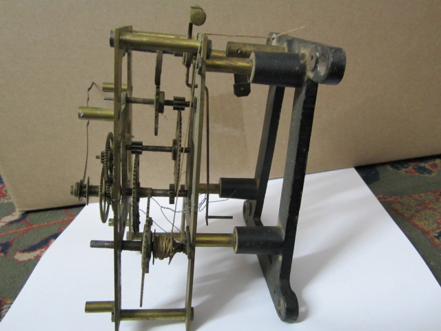

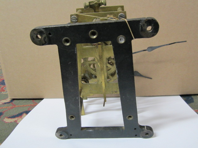

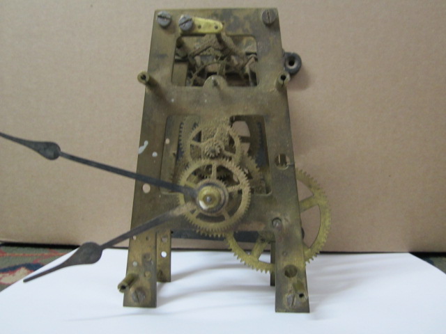

I have this Seth Thomas one weight movement with hands, I couldn't find any markings on it.
May 23, 2012, 15:11
Sam Hansen
side view
May 23, 2012, 15:11
Sam Hansen
back view
