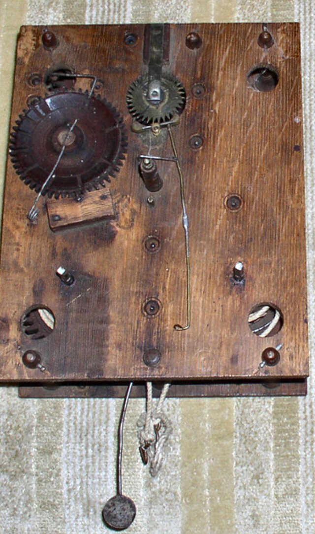

Is it possible to identify a wooden movement? The only information I have is that its made from Cherry & Oak wood. Thanks

Wayne,
The issue you want to look at is Supplement#19, Spring, 1993.
The closest I could find was an Elisia Hotchkiss Jr.
From looking at the front plates in your picture and comparing it to the pictures in the book, The only difference I could spot was the position of the retaining spring on the count wheel. all other hole and angles of attachments seem to match.
Much of the identification is done by tooth count on the time and strike trains. The book also mentions who, besides the maker, used those particular movements.
Identification is tricky and all details must be looked at.
I would scan the picture in the Supplement, but my scanner has not found its way to the boxes that have been unpacked.

I have what appears to be an identical movement in the shop for restoration but can't identify maker. I have a photo on the way to Don Bruno who seems well versed on wooden movements.He also fabricates wheels,gears, etc. His E Mail: torringtonclockco@clockcollecting.com
