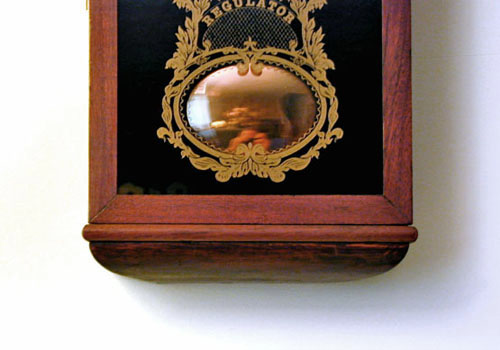

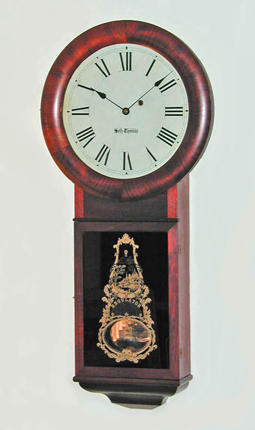

One of my favorite clocks is the Seth-Thomas Number 2 of which the design went through changes over the years.
In the images below you will see my earliest one, it is from around 1876 production. At some point a decorative part that belongs at the bottom of the case had been lost. Apparently this happened from the huge cast iron weight breaking loose and crashing down through the bottom.
I've had this clock for about seven years now and all that time have hoped it could one day be complete. One of our members, Tom Boone generously offered to do the woodworking. To accomplish that he will need clear pictures of the base taken from the front and both sides.
You see what is missing from my early Number 2...May 31, 2007, 19:00
The bottom-most part of my case
is missing!
Do you have a complete one to photograph for us?May 31, 2007, 19:00

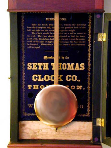

Here is the way my early Number 2 should look.
This is an image of my clock in a factory catalog...May 31, 2007, 19:00
Later they added a seconds register but case is unchanged.

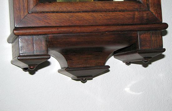

And here's a better image from a later ST catalog...May 31, 2007, 21:15

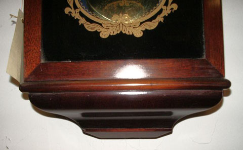

Rich De YoungHi Lindell,
Here is a picture of a later version of a ST #2 bottom similar to yours. This one is on ebay now.
Seth Thomas # 2Another Seth Thomas # 2May 31, 2007, 21:21
Thanks Rich,
Unfortunately, the first example is a reproduction, the second is a far newer clock than mine and therefore it uses a different design on the lower case. We saw those earier today, and that is a start. What we really need to find is an earlier clock of 1870s design like mine. And as I suggested, seeing details of the side view is what we need most of all.
Again, thank you!

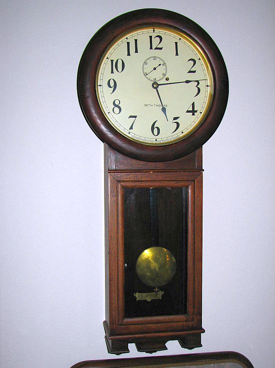

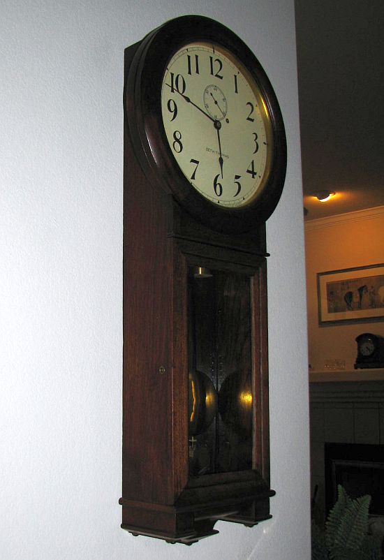

Dave FreemanHere's a picture of my Seth Thomas No. 2. I've owned it for ten years or so,
and apart from when I stop it for our vacations,it's been running strong every
day since I got it.
Dave Freeman
IHC Member 321
June 21, 2007, 18:43

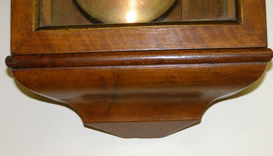

Dave FreemanHere's a closer view of the bottom of my Seth Thomas
Dave Freeman
IHC Member 321
June 21, 2007, 18:50
Dave FreemanHere's a bit more of a side view.
Dave Freeman
IHC Member 321
June 21, 2007, 20:19
Thanks Dave,
You have a nice, considerably later model. I really appreciate your efforts, but my clock is the somewhat earlier model with a huge cast-iron weight in the back. You'll notice it does not have a seconds-bit either. This clock is early and dates to approximately 1876 production. See the image below for more details.
Thanks to you and anyone else who might be able to help with this.
There is an iron weight behind the partition...June 21, 2007, 23:49

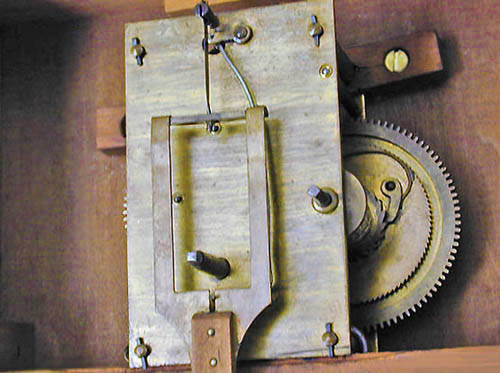

Bernhard SchmidtI´m just curious but does anyone have a picture of the movement. Really nice clock. Haven´t payed attention to it before really.

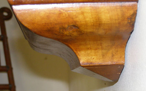

Larry StewartLindell,
I think these are the pics you need. This clock has the large weight behind the sliding board and the round terry movment.
June 24, 2007, 21:41
Larry StewartHere's the other pic.
June 25, 2007, 15:08
Larry,
That's exactly what we need!
It was great talking with you a few minutes ago. I especially appreciate your willingness to trace the bottom piece, record the dimensions and send that along by mail. This is what our wonderful hobby is about, helping each other.
Thanks a million,
June 26, 2007, 07:48

In response to Bernhard's question the image below shows the very simple but amazingly reliable movement in our Seth Thomas circa 1876 early Number 2 shown in this topic.
Your comments are invited!
Movement in my Seth Thomas circa 1876 clock...June 26, 2007, 16:51
Bernhard SchmidtYes, like the precision pendulum, suprisingly simple on the first site but truly reliable and accuratly made. Guess that´s something like that according to this movement aswell, isn´t it?

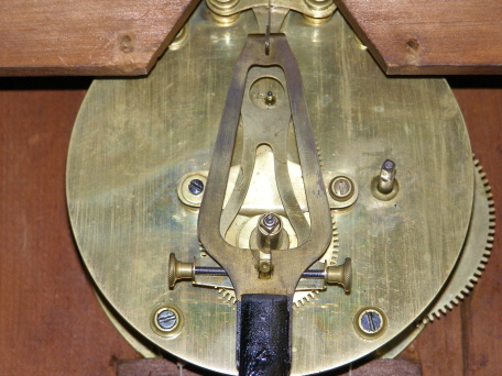

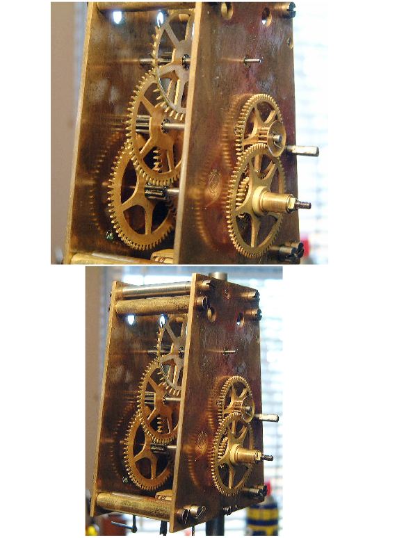

Here is the so called round Terry movement from my clock. Notice the beat adjustment and the pendulum leader. These items are very similar to the set up on my weight driven ST No. 1 double dial calendar clock. I've owned 1s/2s with the rectangular movement like yours only the mounting method was very much like an OG with the movement on a seat board with vertical support pieces.

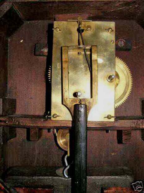

Here is another movement almost identical to mine in a slightly later Seth Thomas on eBay right now. It even has an identical board and the same mounting brackets as those in my clock.
That one is claimed to be 1879 and it has a seconds register.

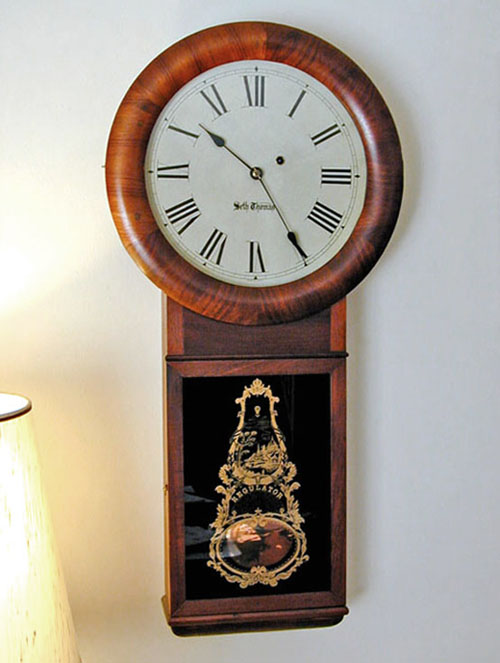

Yesterday afternoon Tom Boone called.
He said the clock case was ready and he would bring it home.
After seven years of ownership my oldest Seth Thomas Number 2 was whole again.
Thanks to Tom Boone for his craftsmanship, to Larry Stewart for his wonderful close-ups and tracings, to Gary Morgret for images of similar clocks he found for us, to Grant Perry, Dave Freeman, Rich DeYoung, Bernhard Schmidt and everyone else who offered assistance or found this topic of interest.
Thank you for your help and for understanding that our mission as serious collectors is to leave these wonderful horological treasures better than we found them, that when we restore a case like this it must be a faithful and accurate restoration to the original specifications.
Accurately restored, the case is once again whole...August 02, 2007, 19:46
