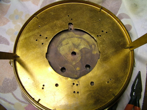

April 05, 2011, 15:05
Ken Snowden
ST-Doric Dial & Bezel Back
As you can see this plate has been really hacked up by mounting a replacement movement to it.

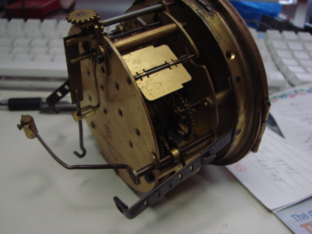

April 05, 2011, 15:08
Ken Snowden
ST-Doric Original movement.
This is the type of movement that was originally i the clock. I would think that the platewas drilled for mounting to the holes that are at 9:30, 6, and 2.
April 05, 2011, 16:25
Tom Brunton
that is the position of the holes on my 120F Seth Thomas movement. My bezel is 4 1/2" and center right is the post from the movement plate to the dial plate

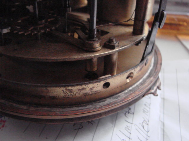

April 05, 2011, 16:26
Tom Brunton
#2
