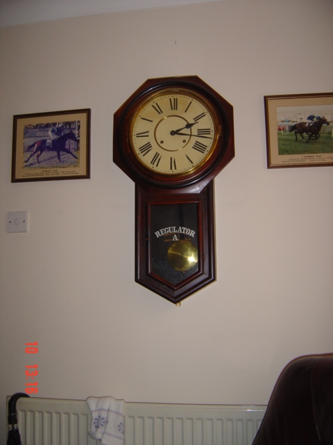

Ged PitchfordAnsonia Regulator A, Clock is now on my wall at home. It is running and keeping reasonable time, however the strike is an hour out, struck 12 at one pm. I'll let it run awhile and then pull the face to have a look at the movement. Could the strike got out of sync' by me moving it to my home?. I just thought if it did what's to stop it happening again when i take it back?. Advice welcome, Ged.

Ged PitchfordHi All, Clock is still running, keeping good time and strike is now in correct sync' thanks to Tom's advice. I think I will pull face tomorrow and check all is okay with movement. The only remedial work iv'e had to do so far is put clock in beat by tweaking the crutch and putting the strike right. Will keep you informed, wish I knew how to post pictures. Ged.

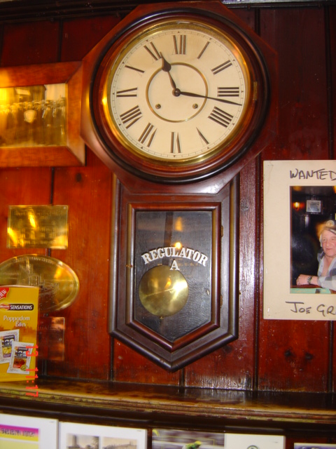

Ged PitchfordHi All, Forgive me if I get this wrong, I am trying to post picture of Pub Clock, Here goes,

Tom SeymourGed,
Thanks for the picture. That's a beauty!! I've always liked that model! Glad you got it going again.

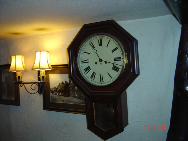

Ged PitchfordChecked on clock, it's running well, good job Joyce is away I forgot the time and I didn't leave til closing time. there is a clock in the other bar and the landlord is hinting I should take it home and check it out, but i'm not too keen on getting involved. Other clock
