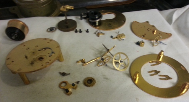

I was introduced to Ron B., an old Chelsea Clock restorer who was able to build a seconds hand and source a main spring for this "K" series clock.
Thankfully, the gear train is in excellent condition and only needed a thorough cleaning.

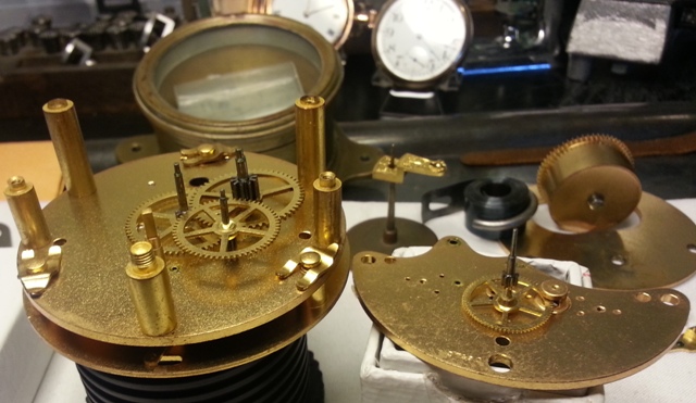

The gear train layout is fascinating.
It defies reason how they make the transition from the absolutely robust main floor gear train and jump upstairs to what amounts to an 18s escapement and balance regulator system. My reading indicates this escapement was developed and made under contract with A.M. Waltham.
Beautiful in the simplicity, all the pivots are polished to a mirror finish and cleaned up like new.

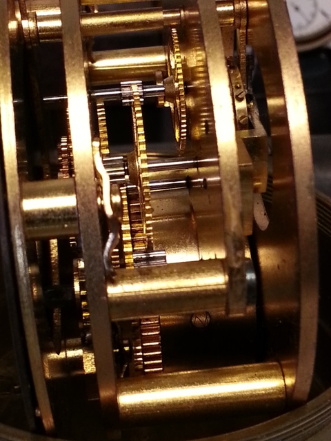

This is what she looked like before I cleaned it... it only gets better from there.
I added this photo to show how the torque and power from the floor get upstairs to the escape.
In a full plate 18s the pallet fork makes that transition.
Here, there is a reduction gear on a long shaft that makes the transition.

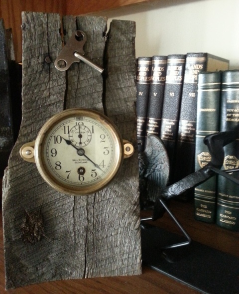

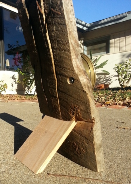

The best I can estimate is that this clock was cased for an industrial or yachting application. Since I couldn't afford a yacht, I snagged an old plank from the boat yard I do business with and had some fun with the display.
January 24, 2015, 13:49
Paul D. Trombley
I found these RR Spike book ends at a county fair in St. Louis back in '91
So far, looks like she is keeping time within a minute or two a week. Ron B. tells me this is great for this model and not to chase it out beyond that.
