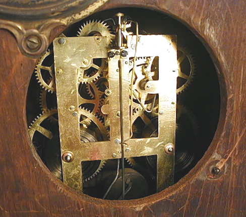

Seth Thomas Movement

The only information I can give is that in the first movement: has what is generally referred to as a "Cathedral Gong". This type of gong has a deep tone rather than the wire type gong which sounds more like a clang. I cant' tell if it strikes the half-hour.
Second movement: Sounds the half-hour on the bell and sounds the hour on the rod. I see that the Seth Thomas also has the three plates, the main wheels being on the third plate.
Both should have a nice sound. Both look as if they've been cleaned. The cases look in great shape.

Thanks Greg, They both strike the half and whole hours.And they both have been cleaned, pivots polished and bushings replaced where needed.The finishes are as original as well as the dials. That much I know. Glad to hear I could expect a deep gong on the first. I love that sound. Did not know the Thomas struck the bell on the half and the hour on the tuned rod. And am interested to know what it means when there's three plates??? Thanks for your comments

The third plate is of no interest to the owner, but is a bonus for the repairman. Both springs can be let down into clamps, removed, and the rest of the movement is intact. That's my opinion. Some people hate three plate movements. I like them. I get a good long last look at the condition of the rest of the movement before I put the power back on.
The Welch looks great, but again it's hard to tell from small images. I'd say that it's had long service, judging from all the beat adjustments. See how kinky the wire is? The clock was moved several times.
Speaking of that, don't despair if either clock doesn't run right away. You might just need to set the beat. I've turned on email notifications for this thread. Post here again if you need instructions.
