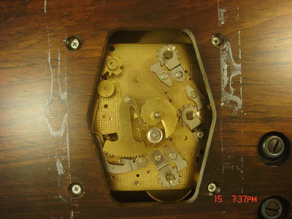

Jim RobsonWell... that sure is great response to my call for help.
The good news is that the clock is running. Thanks to Gary, I found a spot where the beat is equal. Problem is the clock looks pretty silly tilted at at least a 5 degree angle. The amplitude is not great, but it has run for 2 hurs so far.
How do I change the beat without rotating the clock? I assume there is some equialent to a roller jewel that I can move.
I have the hands off and the screws out of the edge of the dial, but the dial won't budge. There must be something else holding it.
I may still need to replace the movement since the amplitude is so weak, but I would like to give it a try first. The movement is Harris & Mallow West Germany. Is that one of the hopeless variety? Some of the pivots are caked up with dried grease. This clock does look to be from the early seventies.
I appreciate all of the help and encouragement.
Thanks and regards to all, Jim

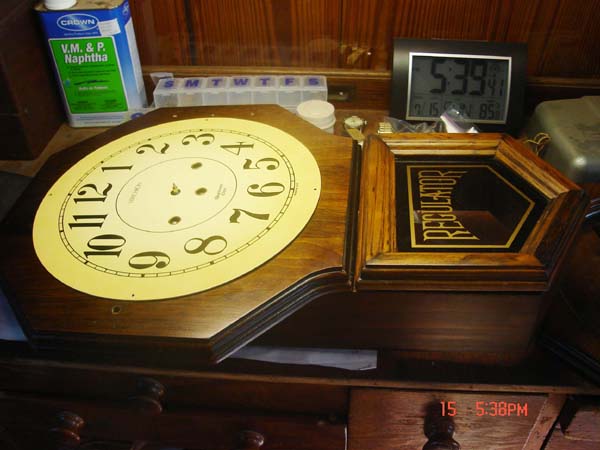

Jim RobsonThank you John... I now have the clock vertical and it has run for seteral hours with equal beat. Your instructions were superb.
My options are somewhat limited as to the manner of repair, being on a budget. I was fortunate to find this gem in a thrift store for $15 so I'm inclined to clean and oil it myself.
The dial is still holding fast and even though I've removed the screws, there seems to be something else holding it. Anyone have a suggestion? Once that is accomplished the photo requests will be filled post haste.

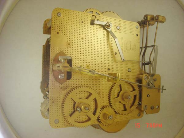

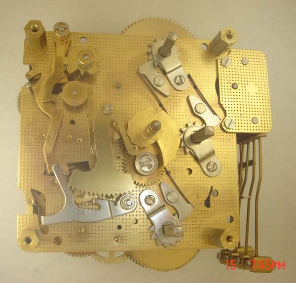

Jim RobsonHere are the photos.
July 15, 2007, 21:38
Jim RobsonMovement
July 15, 2007, 21:39
Jim RobsonMovement Front
July 15, 2007, 21:40
Jim RobsonRear

Jim RobsonHi all, I have it all re-assembled now and keeping time. Next question... how do I make the chimes work?
Regards, Jim
P.S. the dial was held on with double stick tape.

Tom SeymourJim,
Great job thus far. Is there any movement in the strike or chime trains? The bars across the hammers are used to stop the hammers from hitting the rods. I am not sure from the picture, but it looks like they may be blocking the hammers from moving. Just move them out of the way. If there is no movement from the gear trains then we are at a whole other place for troubleshooting.
July 16, 2007, 03:00
John WoolseyGreat Job Jim, looks good!
From the photo's it looks as if the bar which should hold the hammer rods away from the chime rods is on the wrong side of the hammer rods, if so, the barrel which lifts the rods won't be able to move - it and thus the chime train will be locked!
Effectively, they appear to holding the hammers against the chime rods and not away from them.
The bar is used to manually lift the hammer rods away from the chime rods (ie: to stop the chime at night), but will still allow the chime barrel to rotate.
Take it off and replace it under the hammer rods and see how it goes!
John

July 16, 2007, 13:49
I think John found the problem.
Thanks John!
Of course the whole point of that hinged retainer is to keep the hammers from striking the chime rods when transporting the clock. Unless the retainer has been installed improperly it should be easy to simply move it so that full hammer motion is not restricted. Perhaps a closer image of the hammers might help in understanding this one better.
Evidently they held the dial in place during assembly with "two-way" tape and then installed the screws. Over the years that tape can become very difficult to remove. I wonder how many of those dials have been damaged when overly-aggressive people tried to remove them. Good for you Jim in being patient with the dial removal procedure.
By the way Jim, what is that information stamped on the movement?
