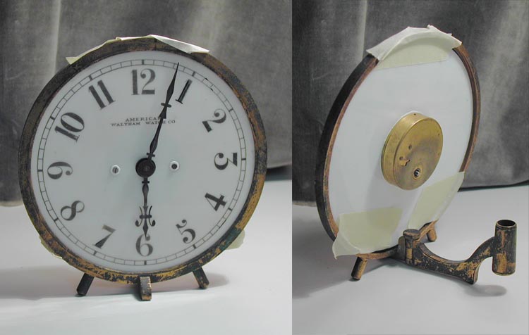

Well, time flies and my restoration projects move very slowly. I picked this one up again and got the movement working and mounted to the dial. Unfortunately, I think these original hands may have originally gone with a roman numeral dial. As you can see, the dial is currently held in the frame with masking tape, and I don't have a winder yet. Does anyone have any tips on how the winder should look? Also, does anyone have suggestions for cleaning the gilded metal frame. It is pretty gunked up with a century-worth of grime and probably soot.
