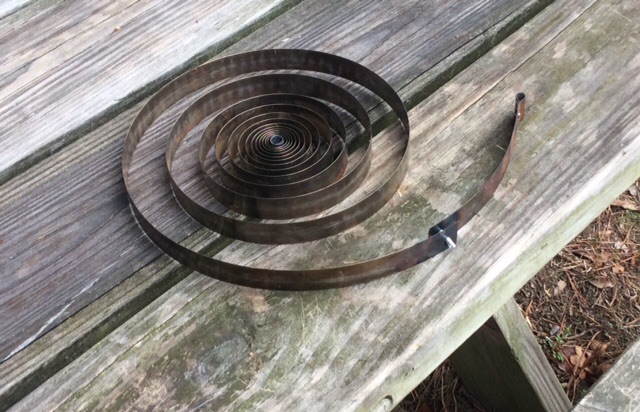

I am new to this. Thinking to save a scrap learning/practice Gilbert clock mainspring by reforming the loop end. About 6" was snapped off when I got it.
I saw this quote in another post, would this work for mainspring? Then rivet?
Thanks
Mike
Quote:
Heat the spring end to bright cherry and IMMEDIATELY!!! plunge it into a five gallon bucket of cool water, swirling it around in the water as you plunge it. (Remember, a large volume of water is important - the old blacksmith used to quench a single horseshoe into a 55 gallon barrel of water). Polish the surface, so you can watch the colors. Reheat to draw the temper at a dark blue, and quench in automobile motor oil.

The .75 width and 0.180 thick spring would succomb to manipulation after this treatment?
April 10, 2015, 13:54
Mike BendaWent ahead, maybe it won't be too dangerous.
Before pic. Yes it was in the movement with an aluminum rivet splice.
April 10, 2015, 13:56
Mike BendaAfter. I will tie the movement to a tree out back when testing this spring.

Paul D. TrombleyGood stuff Mike,
Time Savers probably has a new spring for about $10... it's the small purchase fee and shipping that kills me.
I don't see why that wouldn't hold up well. The only compromise is that it will take a couple hours off the run time of the clock.
April 10, 2015, 17:05
Dave TurnerYes Paul, I'll second that. Nice job Mike! I've seen clocks with previous repairs to springs that looked pretty sloppy, but they ran!

Mike BendaThanks for the support. I will "spring" for the new springs when the two Gilbert tambours and the amandine get redone. This was just for learning. Then on to the PW's.
It is great to have this site as a resource, I will have plenty of questions as we go along.
It is running like a champ! This will be mounted on plexiglass for skeleton display. Mike
April 10, 2015, 19:42
Mike BendaBetter pic. Brass says '23.

David E. Booth, Jr.That quote from me was correct insofar as it goes.
I have had mixed success with re-forming hole end springs for French clocks, where a heavy-handed winder tore out the hole, but have never tried to repair a loop end spring, as they are readily available new. (Hole-end springs are, too, but in a limited range of strengths.)
Attached are some handy charts, and two pages from a long-out-of-print book, Modern Gunsmithing, with a good discussion on tempering.
Remember, the process I described was for hardening and tempering. In order to work on the spring it must be annealed. That requires heating it to its critical temperature, and allowing it to cool SLOWLY!
Here is how we used to do that to make leaf springs for antique firearms from old automobile spring:
Using your wife's best pie pan and some sand stolen from your kid's sandbox, bury the spring in the sand, and lay a polished bit of spring on top of the sand. Heat the whole shebang over the gas kitchen range, until the spring lying on top is dark cherry (not bright red - it is exposed to the air, and is therefore about 100 to 200 degrees cooler than the internal spring you are working on). When the "tell tale" spring you can see is just red enough to tell it is no longer dark, turn off the heat, and allow everything to cool to room temperature.
Alternatively, you can sometimes anneal just the end of the spring where you want to work on it by wrapping it in iron wire, and heating it with a propane or gasoline blow torch. Some springs will anneal that way; some will not. Ya pays yer money, and ya takes yer chances.

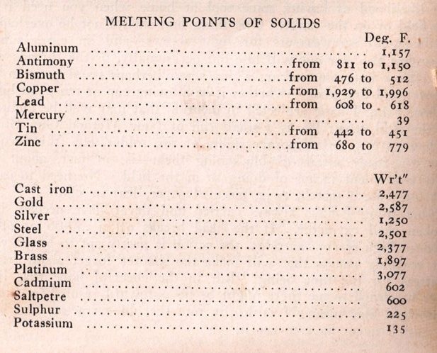

David E. Booth, Jr.And here is one, showing melting points of various materials, if you want to use a bath to temper various items:

David E. Booth, Jr.MIke, I think you are well=-advised to "spring" (all puns intended) for a new one. It wont' set you back nearly as much as repairing te broken pats of the movement or case it your repair does not hold. And it won't hurt you narly as much as it would if the spring breaks loose while you have your hand on the winding key!
Try, if you can, to get one of the replacement springs made in Germany. (Sometimes they are in short supply or unavailable and back-ordered for up to several months.) The springs made in India vary all over the map for quality control. I have had some that when I took them out of the shipping wire to clean the protectant off them, were so soft they only opened up about a quarter of an inch in diameter.
Incidentally, that spring you have is "set"; the inner coils are not opening nearly as far as a new one should. IF you ae going to mees about with clocks with any seriousness, hang onto that old spring - you never know when you will need a piece of high carbon sheet steel to make a part or a tool. The metal cutting wheels they sell for use with high speed rotary tools do a great job of cutting those springs. (But wear a face safety shield and heavy leather gloves, in case the wheel decides to break apart while you are using it. You don't want to know how I know this.)
