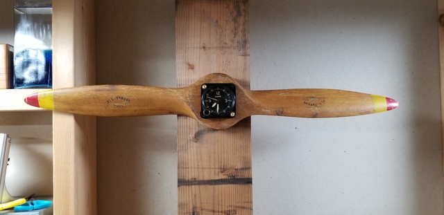

$30 is a great price if it just needs COA. Even if it needs parts still not bad at all. A friend gave me a model prop after I got my pilots license and I put the Waltham clock I had in it. Looks good. See pics.
Roger

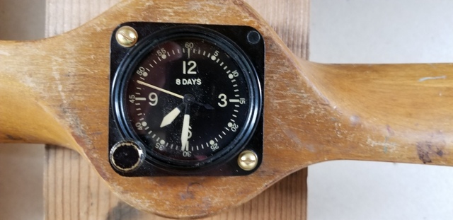

June 16, 2018, 17:10
Roger J. Nolfe
Note location of winding/setting knob. I think this is more common than yours.
There were a lot of manufacturers of these and yours could even be non-American.

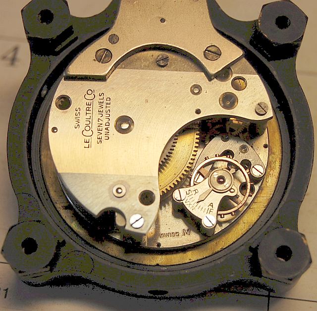

Got the clock today. Somewhat disappointing. Wound up tight. I think the mainspring is okay. Balance staff broken and pallet fork laying loose in the case. Otherwise it looks like it is repairable.
But I can't figure out how to get it out of the case. The stem needs to be removed and so far I don't know how to do that.
It's a 7 jewel Swiss LeCoultre Longines-Wittnauer.
Dave Turner
June 18, 2018, 13:04
Roger J. Nolfe
That's too bad Dave. With the pallet fork loose the clock should have no power on the mainspring. See if there is a snap ring around the crystal. It might be hard to see. That is what normally holds the movement in the case. At least on the aircraft clocks I have worked on. Any LeCoultre I have seen was well made.
Roger
June 18, 2018, 13:35
Dave Turner
Thanks Roger, I've studied the dial carefully. No retaining ring, no bezel. The whole front section is one piece. I think the train is locked up and the spring is wound tight.
Upon further examination, I see the escape wheel turning freely. And the adjacent wheel, forget what you call it is also turning freely, but then pinion on the next gear is not meshing. Gear train has been installed incorrectly! Some kind uneducated soul has done this clock no favors.
I removed the balance cock and the pallet bridge. Made sure the train would not spin out of control and let the spring down gently in the case.
Every thing looks good except the balance staff. Train spins freely and no broken teeth or pinions.
But until I figure out how to remove the stem I'm stuck. And also need to source a balance staff or repair.
