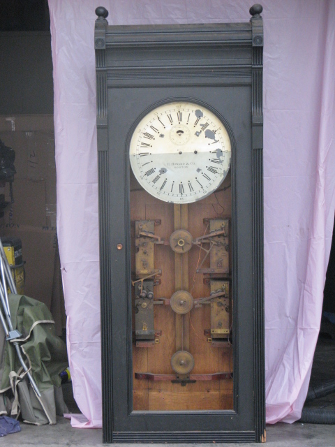

E Howard Master slave clock on ebay Got Info?
I would love to know more about this kind of clock, so if you know this one, would you please clue me in on the workings of this one?
http://cgi.ebay.com/ws/eBayISAPI.dll?ViewItem&rd=1&item...=STRK:MEWA:IT&ih=007

Sheila,
I have not seen this particular configuration before, but this appears to be the master clock. The slave clocks would be in various other parts of the same building and connected to the master by wires.
When an electrical impulse was generated or sent by the master, the slave clock would advance. i am guessing that all the numbered stations you see down the length of the clock were where the slave clocks were attached.
There were many types of master/slave systems. Some were electric, others were pheumatic, with a rubber tube connecting the master to the slaves. The master would have a bellows and a puff of air was sent to the slaves to advance the time.

Tom,
OOPS I did leave out the Master part huh? Sorry.
This information is fantastic, I didn't know about these at all! Were these used for anything spacific, like for work, timing things, or business or? was it just a way to have multiple clocks?

A lot of these clocks were used by schools to keep all class rooms on the same time.

The ones in the school I taught at were pneumatic. Clockwatchers found that the hand moved slightly backwards before it moved forward. The system was replaced during my stint there, and I did manage to get a few of the slave clocks.

You have a very interesting time piece! Some master clocks also send out impulses to energize solenoids for chime systems-for instance the O.B. McClintock (I restored one about 25 years ago).
