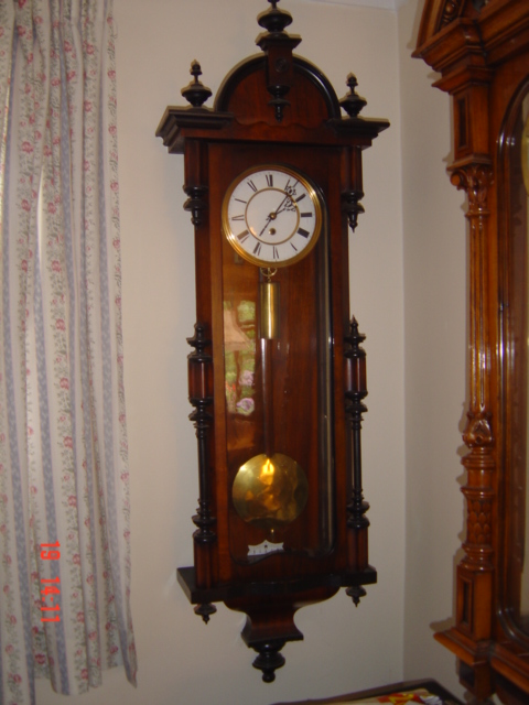

Hello All, My Single Weight has presented me with a little problem, The Hour hand has started to slip and now hangs loosely at or near no 6. I shall have to stop it and remove face to remedy this nuisance. It has been fine since I serviced it and fitted new artificial Gut line 2 years ago. I always think of clocks  as Female, You know, Unpredictable, Ornery and looking to find we poor males a job when we look to have "TIME" (Pun Intended) on our Hands. Regards, Ged.

Tom SeymourThat clock is a beauty Ged!    Floppy hour hand should not be to difficult to fix.

Jim Cope...nice clock Ged!...fashioning a round or partial thin brass shim for the hour tube or sweating a thin layer of solder inside the hour hand should be a 'piece-of-cake' for a plumber/pipefitter...

Ged PitchfordHello All, Hour Hand tightened ,now all okay. My Pencil note on rear of face reminded me of Sept 1996 I paid £325 for it from a lady whose house I was working in at the time ,(fixing her heating system). Thats around $550. I think I did alright. Thanks for interest. Regards, Ged.

Tom SeymourGreat news Ged!  You did very well on that clock.  That is one outstanding case.

Kevin PestorNice clock Ged, and good to hear the repair job is sucessful.
If you get tired looking at that old thing send it to me, i have room on my walls.
