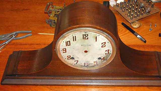

Here's my weekend junk store find - for ten bucks.
Still not worth much, but I love to clean up most anything.
This old clock runs great after a thorough clean in the ultrasonic and some fresh oil, and has a nice mellow bimbam chime.
All I need is a bezel door and glass, and maybe a new hour hand, (the tip's broken off) - not shown in the pictures.
Can I clean the dial without making it worse?

I have the same clock, from my wife's parents home.It was in their home as long as she can remember, and most likely came from her grandparents home.Great time keeper, stays within a half a minute a week.
I cleaned the dial with mild hand soap and a soft toothbrush.Got the dirt off but the discolored paint didn't change any. Anything stronger takes the paint right off.
I cleaned and polished the face of the numbers with Simichrome and they shine like gold.
Steve

Thanks Steven,
I almost didn't buy this clock. But now I'm glad I did. I was amazed at how little it took to get it going and how well it runs.
Sure wish I could find a door for the dial. I'll keep looking.
I cleaned the dial with mild soap and water but haven't worked on the numbers yet. Now I will.

Just found this post. I cleaned up the dial a little. The brass numbers shine now and the dial is a little cleaner.
I'll keep looking for a door and an hour hand.
