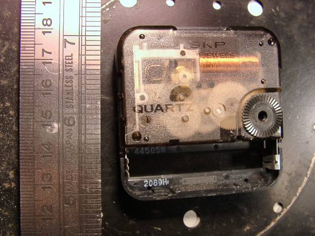

Tom SeymourJohn,
There is a battery mvt. made for high torsion (larger hands)situations. The movement of the seconds hand is smooth. More like an electric than a traditional quartz.
The movement is small - about 2" x 2".

John D. DuvallTom,
Thanks for the pic!
I was talking with Lindell last night and he has pocket watch clock that utilizes a main movement with a seconds movement slaved to it. If you have the S. LaRose 2002-2004 Keep Book, it's on page 227. It cost $8.95 and comes with hour, minute and seconds hand. This is exactly what I was looking for. I can't wait to get the clock and get started. I'm thinking about choosing an Elgin dial that is appropriate for the case design.

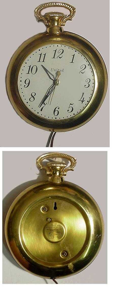

John D. DuvallSteve,
Was it in a pocket watch case? I was just going to make a very large Elgin pocket watch out of this old clock. Attached are the pictures.
Although this appears to be a larger clock, its dial is only six inches. Just enough room for one movement.
