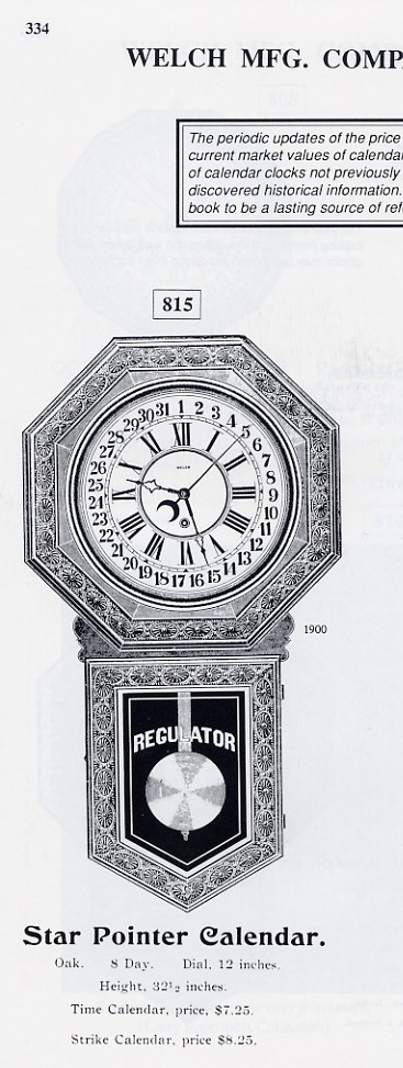

It appears to be a Sessions. that pattern on the pendulum bob was typical of Sessions. Two models had that type of molding. One was 32.5 inches high (1908) and called the "Star Pointer." The other was 38.5 inches high and appears in Trans' book to be a light colored finish. It was made for the spanish market and called "Crescent No.8" (1915)

Tom SeymourObviously from the label I was wrong about it being a Sessions. Although there is a sessions that is identical to it.
This one is an E.N. Welch. The letters at the top of the dial are the ending of "STAR POINTER".
I appears to be identical to the Sessions "Star Pointer" except for the pendulum. The pendulum bob is not like yours, but rather smooth. I will try to scan both and post them.

Tom SeymourThe "fish tail" or fan shaped end of the calendar hand is not shown in the pictures, but is shown used by Welch as a calendar pointer on some double dial calendar clocks. New Haven used the that style on some of their calendar clocks similar to yours. Probably others did also.

Charles R. SidesObviously Welch had a big influence on the Sessions. I would match it up as a Sessions also, except for the label.
Some kind of transition maybe?
Definately a Star Pointer. A real sexy name for a clock, but why Star Pointer... I don't get it.
Looking at the prices on the scans, I sense I overpaid.

Jack WyerIn 1903 the Sessions brothers who worked for the Welch Co. took over the defunct E.N. Welch business. They stopped production of the high end Welch clocks but continued to produce many of the lower priced ones.This clock had to be produced very near the transition date. Check the movement if it is signed by Welch then you probably have a Welch clock, if the movement is signed Sessions then you would have a early transition clock possibly using a left over case. JACK
