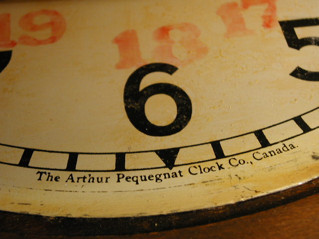

Lorne WasylishenThe clock, sadly has been re-finished and the wooden bezel was re-mounted a few degrees out of whack but I can live with that.
The paper dial you see on the above picture covers the original Pequegnat metal dial that has been adorned with afternoon numbers 13-24.
I only peeled one section to see what was underneath. There is resistance and you can see glue residue in the photo.
Should I try to remove the paper dial?
Potential issues are firstly removing those brass grommets (any hints?) and removing the glue residue without mucking the whole thing up.
Thoughts?

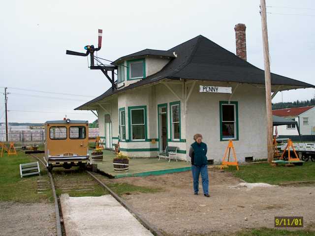

Lorne WasylishenThis is the Penny Station as it sits today in Prince George B.C.

John WillisHi Lorne : Great to see your Moncton and loved the story of how you acquired it. I also have a Moncton. Mine has the original dial (marked Berlin) but it has Roman Numerals and also has the original finish on the case. Re. the refurbishing the dial. First I think you must consider that there is probably a reason why the dial was covered in the first place. That raises the possibility that A) there may be a real ugly on the original dial that you cannot see as yet and B) it is a good dial underneath and you run the risk of removing some of the original paint when you remove the dial. However, If it were mine and considering the history I would want to see those 13-24 red numbers showing.
You should be able to remove the grommets by removing the dial first and then carefully bending back the little clips that are on the back of the grommets.
If possibile determine what type of adhesive is used on the paper dial. If you are lucky it may be hyde or fish glue which you can remove with water. If it is something else you may have a tougher time with it but I would be very leery of just pulling it off cold. You may try heating it with a hair drier (careful) and then try to lift it.
I am sure you will get others jumping in on this one Lorne and maybe there is a better way. I would sure like to see a picture after you get it removed if that is the way you go. John

Lorne WasylishenJohn & Tim, thanks for responding.
If I push lightly on the paper dial there is a crunching sound that indicates to me dried out hide or fish glue as you suggest.
As for why the original dial has the red numbers, I assume some keener operator took it upon himself to spruce up the clock using a stencil, they don't look professionally applied. Penny was in the middle of nowhere and perhaps the project filled in a long winters evening.
The paper dial was probably a later CNR issue after the Grand Trunk Pacific became part of CN, (1918-1923). Perhaps they sent out a kit and you selected the appropriate pieces. The seconds bit is a separate piece glued on to the main dial.
The last statement is however,all speculation and easily refuted as I have a picture of a Moncton (taken in the 70's) that was in the Kiwanga station about 300 miles west of Penny until the mid 1980's. It has the original Roman numeral dial, no adornments.
I am going to do a bit of tender exploration and see how that glue responds to water on a Q-tip.

Lorne WasylishenTom called me last night and we had a bit of a conflab regarding Pequegnat and other things, thank you Tom.
I got the hands off and after very carefully removing the brass grommets went and ordered some new ones on ebay. The added thickness of the paper dial didn't leave much "meat" to work with when they were reinstalled by the "24-hour Michelangelo" so were pretty well useless when I was done.
I think what happened is that the Trainmaster came along , saw the red afternoon numbers and asked of the operator "What the h*** were you thinking?" "I want those covered up". and sent him the paper dial.
Whatever glue was used(which was not required as there are 7 screws and 2 grommets holding it in place) can be shifted only by acetone/lacquer thinner. Sadly it also would remove the paint on the dial so it will remain as is.
The red numbers were somewhat more vivid but much of the colour has been sucked up by the back of the paper dial.
So, no new dial, this one is a part of this clocks history and since it will be donated to it's old station value is not a consideration.
I will post some pics after I figure out why my camera went sideways.

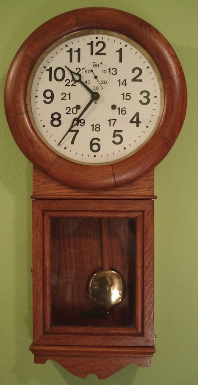

Lorne WasylishenWell here it is, it ain't purdy but it is original.
Had he put the 23 beside the 11 (Like the 13-1) rather than beneath it there would be some visual balance.
A bit of paint loss during removal of the paper dial and a layer of glue that cannot be removed.
All in all I am happy with the result.
I will install the new brass grommets on the original dial and mount the paper dial behind it so it won't be lost.

John WillisHi Lorne: Thanks for putting the "after " picture on. I think you have done the correct thing with it. It is what it is. I noticed the original dial is Arabic and does not have "Berlin" on it. I am not sure when that change was made (during or right after WW1) but it is the first Moncton that I have seen without it.

Lorne WasylishenThanks John, yes, it looks happier this way, like a guy who just got out of his suit and put on "something more comfortable".
I will have a look at rotating that bezel to the proper position, the old screwholes should still be usable.
