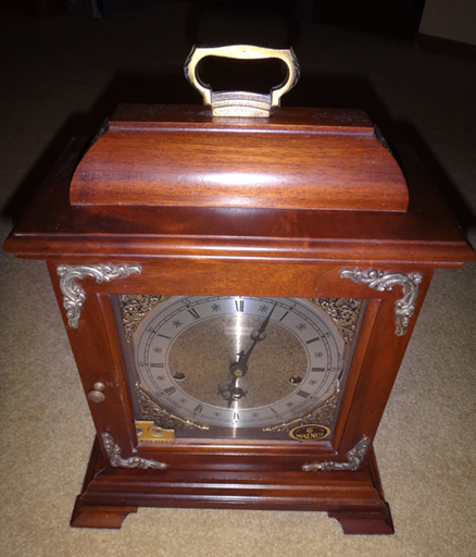

We just received a clock from my wife's grandfather tonight. It is a Hamilton that was presented to him for 40 years of service to his company. He received it back in the mid 80s. I'm just looking for information about it. Age is my first question. How common is it? As of now, it isn't running. I softly tested the attached key and there was no budging anything. Could it be overwound? Something else? At best, it would be nice to see if there is something simple to get it working again. Any information or comments is greatly appreciated. This is the first picture and a few others will follow. Thank you.

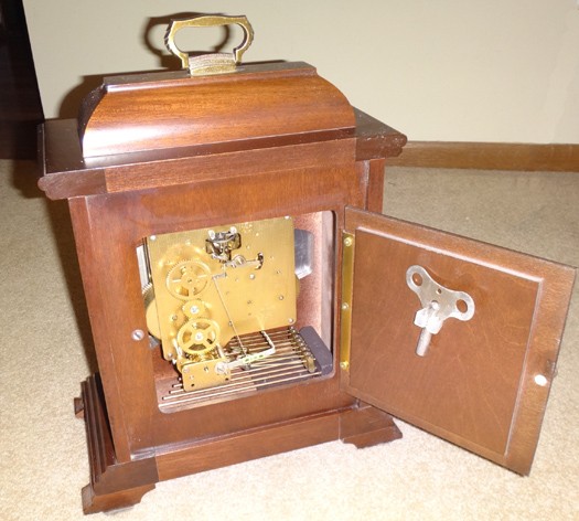

Edward A. HustonPicture 2. The front of the clock.

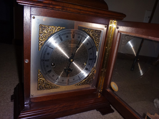

Edward A. HustonThe inside back. It is a chime clock.

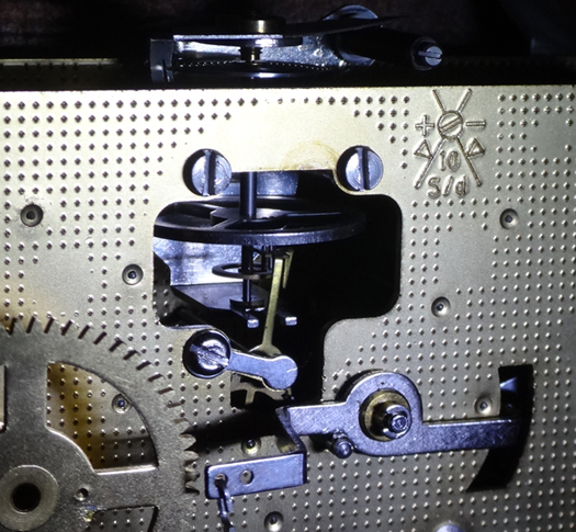

Edward A. HustonWhat info I can find on the surface with tearing it apart.

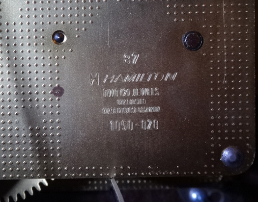

Edward A. HustonHere is the last photo. Once again, any info is greatly appreciated.

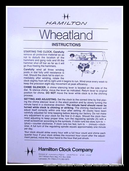

Buster BeckLooks like a vintage 70's-80's made in Germany for Hamilton Watch mantel clock called "The Wheatland" model.
Here's the instructional manual that came with them;

Dan CarterI have a Hermle 340-020 which has 5 hammers and 1 chime. Yours looks to be a 1050-020 which has quite a few more hammers and chime options. I am NOT a clock expert but messed with a scrap 340-020 and will let you know what I can.
There are three barrels (chimes, time, hour). You can see the holes in the front. To let down the mainsprings, you will have to take the movement out of the case / cabinet.
To do this on mine, you have to unscrew the nut holding the minute hand on and then gently remove the hour hand. Turn the clock around so you are facing the back and Remove the screws (4-8) holding the movement and then you will have access to the front where you can let down the mainsprings. I used a helper to hold the movement, while I placed the key on one post and used a screw driver the release the "click" a few teeth at a time. There is ALOT of tension here. I mean if you let all of it go or try to let the spring drop down more than a few clicks at a time, something is going to break (finger vs metal....). Take your time, look up a few videos if you plan on doing this.
It might need a cleaning, check the floating balance to make sure it works. These movements were buit super cheap and a lot of times it was more time and cost effective to just swap out the movement with a new one. Check the Bay of "e" to see if there are any working ones to be had for a decent price.
If you don't want to buy a new movement You can also check all the pivots with the movement out and make sure nothing is gumming them up. Sometimes they just get old oil and dust and get stuck. Hope this helps.

Dan CarterI forgot to mention, I think that the "87" on the back of the movement indicated movement build year. So probably around 1987.
