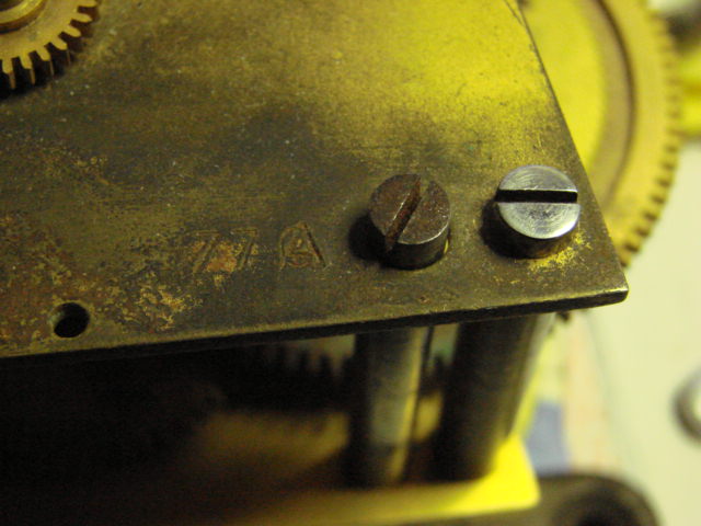

Tom Bruntonthanks AGAIN EDDIE!! ALSO DO YOU HAPPEN TO KNOW ANYONE WITH AN HOUR HAND wheel or gear FOR A 77A SETH THOMAS #2 REGULATOR MOVEMENT for sale ?
THANKS,TOM
July 07, 2011, 18:39
Eddie G. HinesTHE SETH THOMAS #77 MOVEMENT CAME IN 2 DIFFERENT SIZES 80 OR 72 BEAT MARKED A OR B I ASSUME YOURS IS A 80 BEAT MOVEMENT BUT YOU COULD DO A WHEEL COUNT TO VERIFY IT. IT WOULD BE CHEAPER MAYBE TO HAVE A WHEEL MADE THE COST WOULD NOT BE PROHIBITIVE. EDDIE
July 07, 2011, 18:48
Tom BruntonI just double checked the movement and it is marked 77 and has a "C" over an "A" or vice versa????
July 07, 2011, 20:17
Eddie G. HinesIT APPEARS THAT THE A PREVAILS OVER THE C HOWEVER IT WOULD BE BETTER TO DO A WHEEL COUNT THAN TO ASSUME SUCH A THING. HOW MUCH DO YOU WANT FOR YOUR S.T. #2 MOVEMENT AND IS IT AN ANTIQUE? EDDIE
