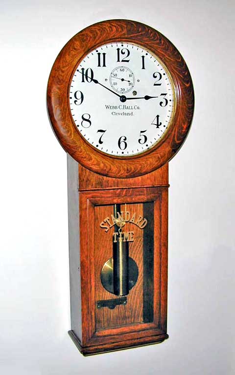

Can anyone advise where I can get some reverse lettering in gold on clock glass? Large lettering on the front glass for a Seth Thomas #9 regulator (this is a very large clock) DO you know where I can order the lettering and put it on myself? Many thanks. Sam

What did you want it to say Sam?
I ask because there are a few "transfers" available. What you refer to is "Gold-Leaf" painting which historically is performed by hand and in reverse through the expertise of a highly skilled sign painter. Today we see this grade of workmanship mainly on the glass windows of lawyer's offices. If you want something specialized try doing a little research, begin by calling sign painters in your local area. When done properly this is a multi-stage process, fairly expensive but well-worth doing right.
"Standard Time" on Railroad Regulator...
