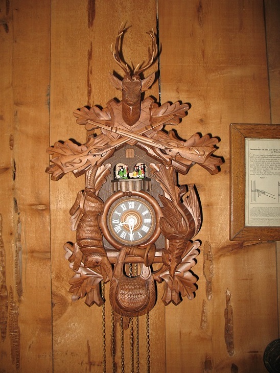

Hi all, I picked up a Cuckoo Clock at a sale today and know nothing about it. It has a couple dancers and is supposed to play music. I thought someone here would know what it is and approx value. It is not apparently running. The case looks to be in good condition, and the documentation indicates a 1984 original sale date.
May 10, 2013, 20:54

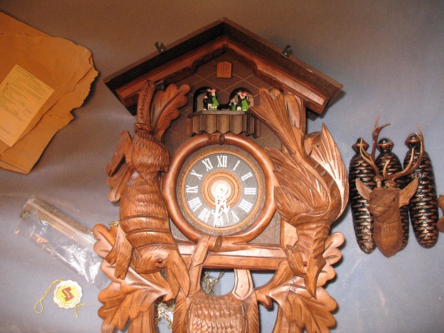

Mike HodgeThere is another carved piece that I didn't photo, the weights are here and appears to be complete.
If it doesn't run are movement replacements reasonable?
I would probably sell it as is but have no idea as to value.
Comments, suggestions etc. happily sought.

Mike HodgeI think it is more complicated than I thought. I did set the clock on a wall and the chains are around the pulleys, the pendulum swings freely and the weights are in place. It does not run but I think it is probably lubrication. It really does look to be very clean so it may be old sticky oil. The original sale was in 1984 and I imagine that was the last time this saw a clockmaker.
