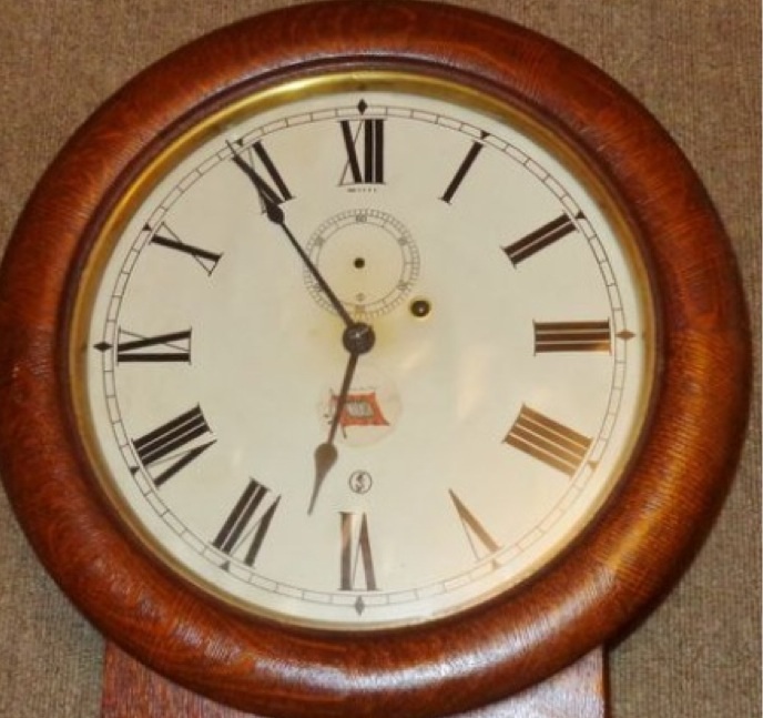

Did the you think this an actually Wabash railRoad Seth #2 or someone just put a sticker on it?

October 01, 2014, 08:08

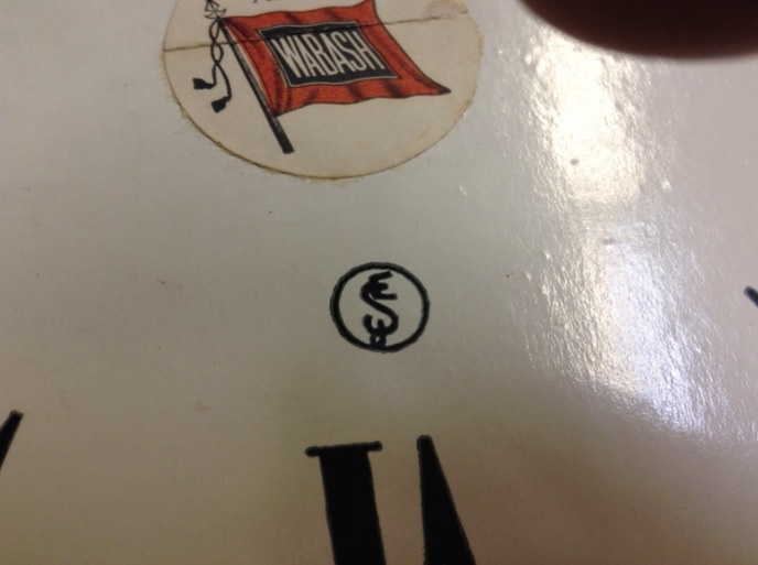

Norman Mayberry
The "S" logo on dial looks like a Seikosha trademark to me.Could be wrong.Look at the movement and see if it is Japanese.I have an old catalog with pictures of all the Seth Thomas wall clocks.All have the ST in a diamond on the dial.Regards.Norm

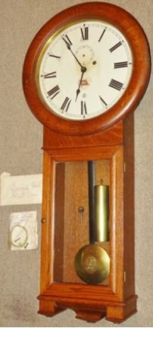

October 01, 2014, 10:27
Tom Brunton
clearly a Seth Thomas #2 Regulator with original dial ~~~~ Wink most likely nothing Japanese about it-just a beautiful clock it would look lovely hanging beside my two #2's Big Grin

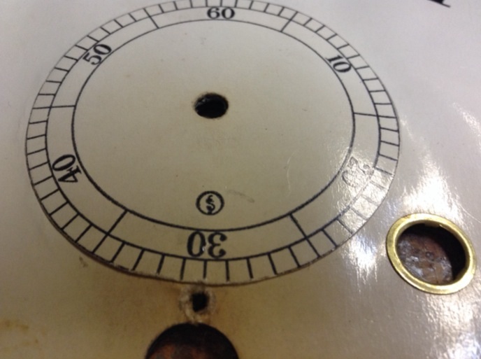

October 01, 2014, 11:48
Lorne Wasylishen
The case certainly looks to be a Seth #2.
I am wondering about the dial, the Roman numerals, hands and outer railway track look Seth.
Ordinarily, on the ones I have seen the bottom half of the diamond below the "6" is cut off by MANUFACTURED IN THE UNITED STATES OF AMERICA.
The seconds chapter is different than the one on Seth's I have seen.
What does it say just below the XII?
I assume these are seller pics so no chance of a close-up of the Wabash logo (it looks like a sticker to me) and the logo below it?
To answer your question, I have not seen a Wabash logo on a Seth.
October 01, 2014, 13:05
Norman Mayberry
I still think the "S" logo is not a Seth Thomas logo.I've never owned a # 2 Seth but every one I've ever seen has The ST in a diamond trademark.I have owned and collected many Seth Thomas mantle clocks and all have the ST in a diamond.Never seen a Seth Thomas without it.Norm

October 01, 2014, 14:43
Tim Poovey
If these are the only pics the seller is offering, not sure about it. I would like to see the bezel open and movement. Looks like there would be more script on the dial, but as my wife says I could be wrong.
October 08, 2014, 00:23
Bill Carlson
I would be inclined to agree with Norm. At least the dial looks "fishy". Maybe the correct case and movement.

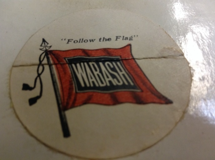

Eugene Buffard
The movement and the case are Seth Thomas. The dial is a paper over metal. With the added bonus of a Wabash pasted insignia. Not original.
The good news is I got at a reasonable price.
It is hard to believe that the auctioneer could not tell this was pasted on.
October 11, 2014, 21:24
Eugene Buffard
The seconds register is also pasted on to the paper dial.
October 11, 2014, 21:25
Eugene Buffard
Here is a close up of the marking.
