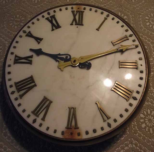

My latest auction find. It is a Self Winding Clock with an 18 inch marble dial and a bronze rim with raised bronze numerals. I found it in pieces at an auction and had a local carpenter make the third band circle and put the case together. I think he did an excellent job.
Does anyone know how to test a Self Winding Model F movement, or know of someone that can? I would love to get this piece running.
Thanks in advance for any help.

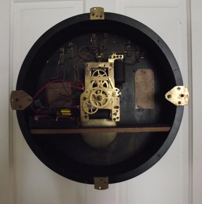

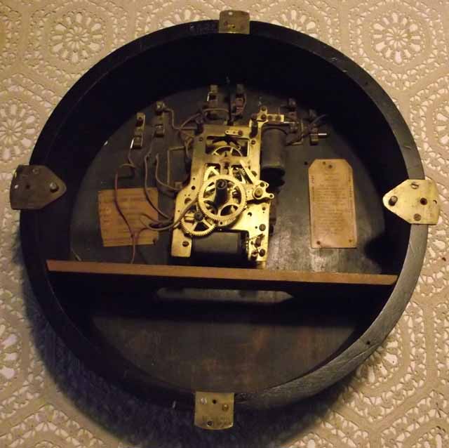

Here is a picture of the case and movement. The three bands of the case are made of four quadrants that are dovetailed together. He had to make the third band and rabbit it out so that the back fit inside. If I cannot get someone to check/fix this movement, would someone have a Model F movement?

Thanks to help from Tim Poovey and a repairman that he knows, the movement is restored and fitted with a D cell battery supply. I now have to make up four bolts with diamond shaped heads that will match the ones on the dial, so that I can attach the marble dial.
