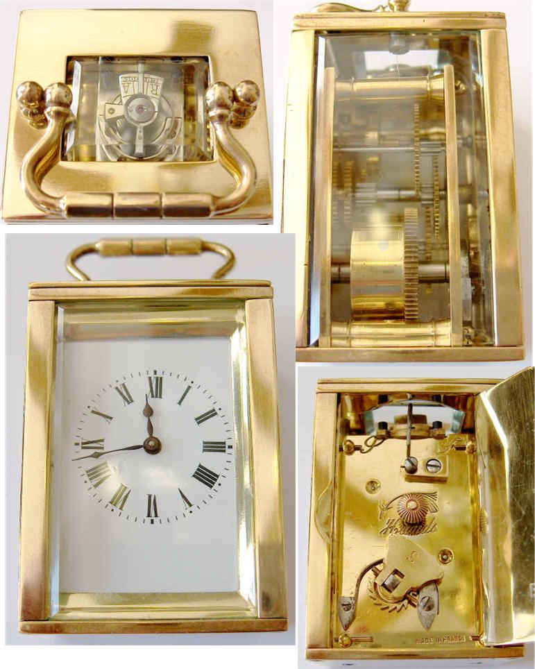

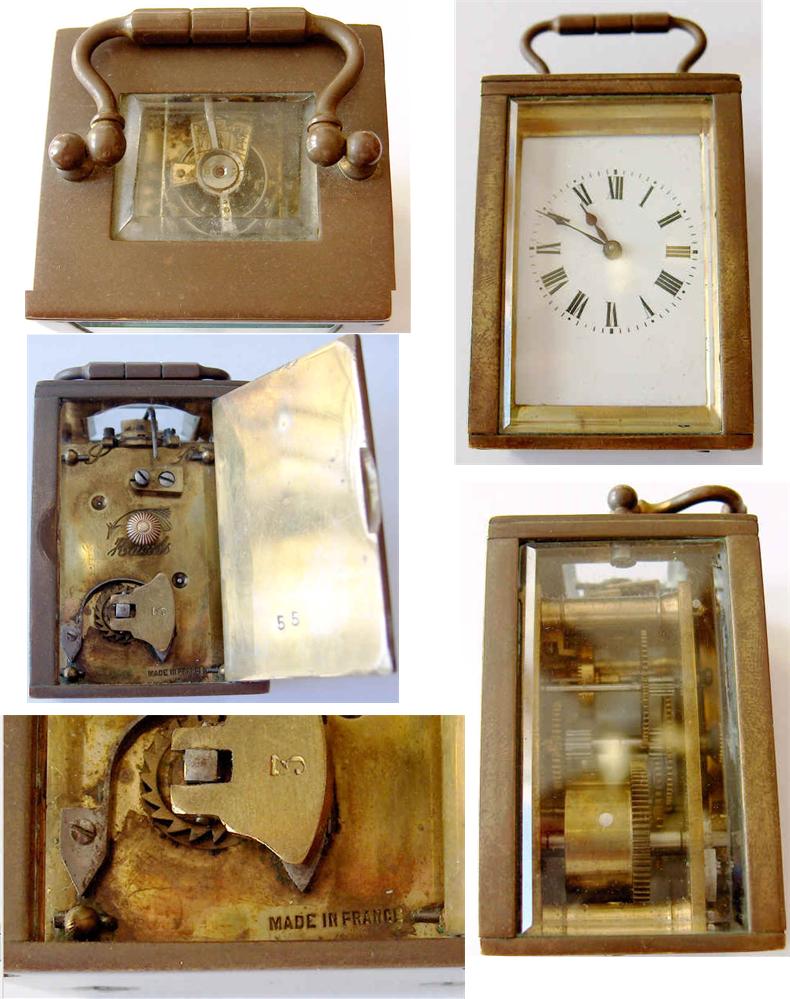

I purchased this little clock recently. I assume it is a French travel clock. It measures 1-3/4 inch wide, 1-1/2 inch deep, and 2-3/8 inches tall. It has a pocketwatch type balance wheel, beveled glass, heavy brass enclosure. It is stamped "Made in France" and "55". Has anyone ever seen one like this before? Any idea how old it is? Value?

French (that wasn the easy part) 1890 and the following picture reads ' polishing ' Big Grin
Gerald

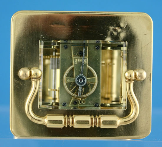

Not the exact one but have a look:
Travel-clock

All done. Runs great. Had to replace the upper pallet fork bridge jewel and straighten the safety pin.

Really beautiful workmanship Mark!
The "before-and-after" pictures tell a great story.

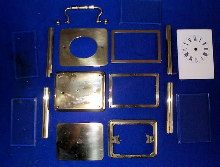

Just so folks get an idea what a pain these can be to put together again, I've added a photo of a typical case assembly in bits.
This is of a similar clock by Duverdry and Bloquel I restored some years ago.
John
Case Components

We also have a couple crystal regulators on the bench at the present. It is an exercise in presenting the parts in the exact sequence for the assembly.
