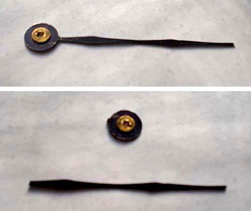

I want to put a new hour hand on a Kienzle Westminster mantle clock.
I found one that looks similar. It has a square hole and needs a brass bushing.
Can someone help me with the procedure for bushing the new hand, as well as where to purchase the correct brass bushings?
Thank you,
Nelson

Bill MarkerNelson I believe the bushing will have to be made. can you post pictures. bill@fixoclox

May 20, 2008, 14:33
Nelson E. TimkenThank you Tom, I will take your advice and braze it.
The reason the hand broke was that the bushing was stuck and just would not move no matter what. I forced it and the thin part of the hand's stem broke off.
Nelson
