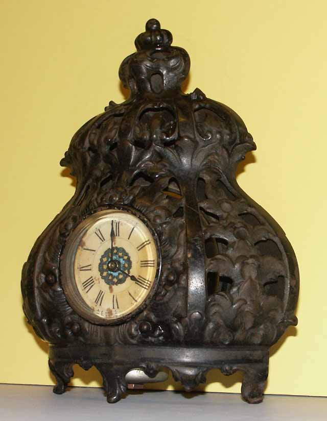

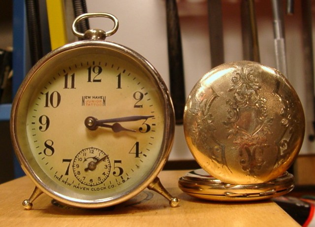

Here it is next to a 16s watch case. It is hard to get an idea of the size when it is by itself.

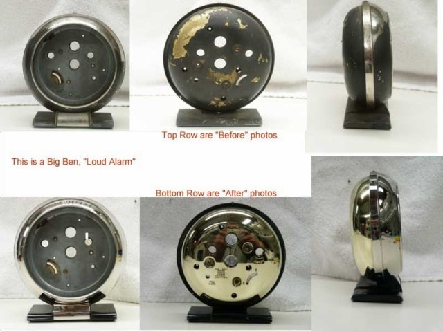

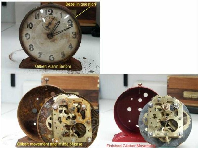

Greg ReevesTom, the following is a photo of both before and after photos of a Big Ben, "Loud Alarm". I used "Kleen Strip", Spray Stripper. This worked much better than the Orange Strip, that I used before.
Also, you will notice in the before photos that the case was for the most part painted. I am assuming that it was original. I don't normally do this, but I think I will leave the nickel and brass un-painted. I'll have to think about it.

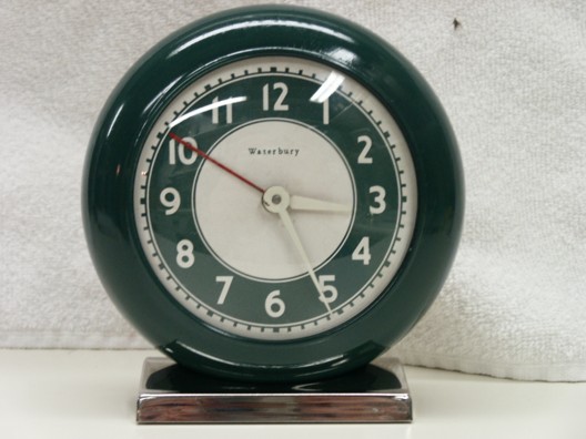

Greg ReevesA Waterbury that I did the other day. Unfortunatly I forgot to take a "Before" photo, but, it was in worse shape than the Big Ben (above).
Greg

Greg ReevesThis is the Gilbert Alarm, which I would like to re-plate the bezel.
Greg

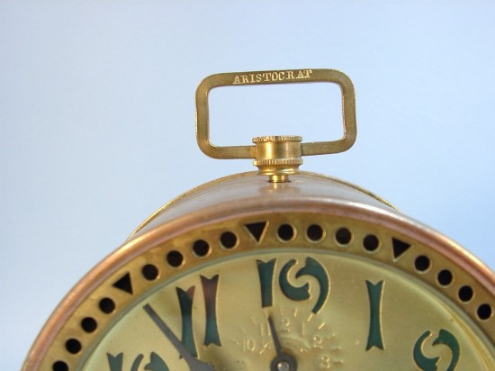

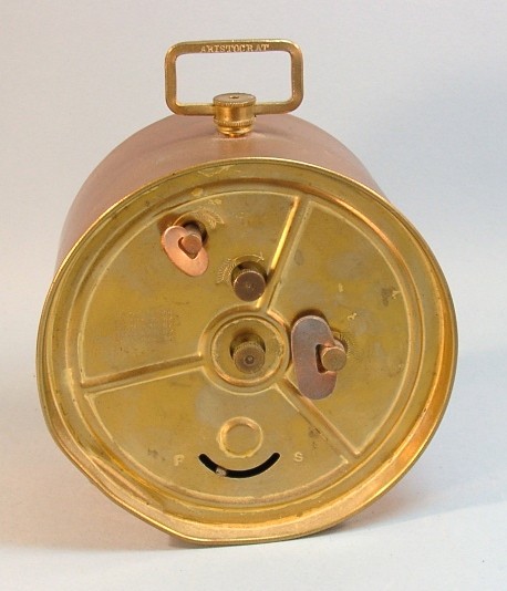

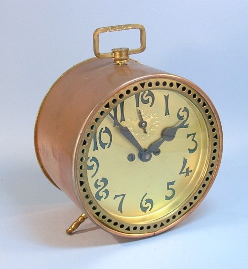

Tom SeymourPromises, promises. Last March, earlier in this thread, I mentioned an alarm with piercing around the dial. I promised to post it when I found it. Unfortunately I put it in "that special place" that took awhile to find. Actually, found it while looking for something else.
This is an Aristocrat alarm. I don't know a lot about it, maybe someone can fill in the blanks. It is the true definition of a "tin can" alarm. The body has a copper finish.
January 12, 2005, 20:45

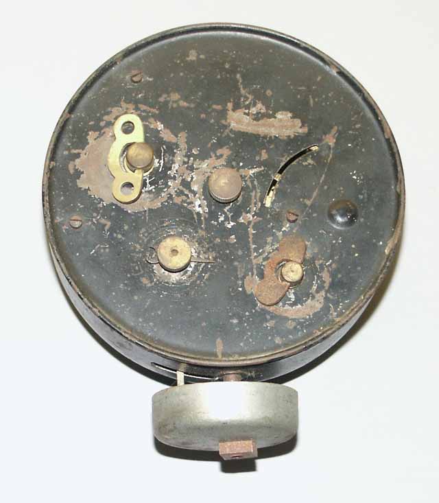

Tom SeymourThe back
Tom SeymourAristocrat

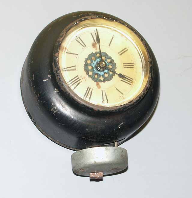

Dick FeldmanI found this “alarm” clock at a Mart a few years ago. I knew it looked like something that I should own. The movement is a fairly simple balance spring movement. It is fairly well built. (No lead pinions, etc.) The neatest thing is that the alarm is a music box movement. The fretwork on the top of the case does not seem to be original and there are a few case pieces missing. Unfortunately this will have to be “before” pictures. One day this project will come up on the list of priorities.

Dick FeldmanThe entire clock is about 10 inches tall and the dial is 2 1/2 +/- inches in diameter. The cup bell is actually a "frost plug" from an automobile engine. I don't know if this is original or not, but it seems to work fine.

Tom SeymourGreat alarms, Dick. Very unusual and interesting. Thanks for taking time to take and post the photos.
You are definitely right about many of them not made to be worked on.

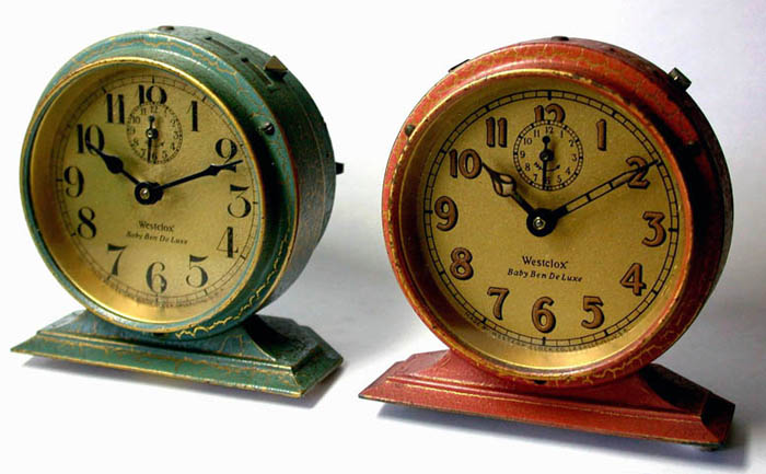

Mun Chor-WengI'm posting a picture of two Baby Ben alarm clocks which I had bought some years ago. They were made between 1928 to 1930. They still look good and work fine after all these years.
Mun C.W.
February 17, 2005, 23:45
Tom SeymourNice ones, Mun. That crackle finish was all the rage. It was used on some banjo style clocks also.

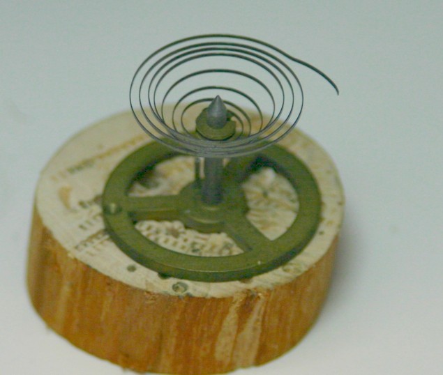

#2. If the spring is too badly mishapen to correct in the movement. the next step would be to remove the balance unit from the movement. I then place the unit in a piece of pithwood to do the correction. the hairsping is in the air, but you can look down on it and find the shape.

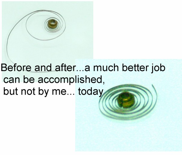

#3. I will in severe cases remove the hairspring from the coil. this process is very good for beginners for practice so that you can really get the hang of the coil shape. I use a pane of glass painted white on one side. lay the painted side down on your counter. remove the hairspring and collet from the balance staff. In the alarm clocks especially you may need to do more that a little nudging...be careful not to mangle the spring or collet. try oil or carefully placed navel jelly between the staff and collet. once you have removed the colleted hairspring...place it on the non-painted side of the glass. make sure you can look down on the work comfortably(probably the most important piece of advice). Then using a couple of pair of good-long-pointed tweezers begin re-shaping the spring from the collet outward. I sometimes will use a very sharp-long-pointed tool that I made(sort of a scratch awl). look at the coil spacing and keep the same distance between each coil. This is a challenge to say the least, but once you get the hang of it its very rewarding(at least to me) to be able to correct these.

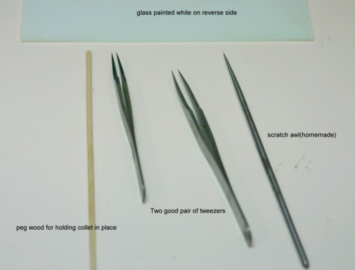

February 18, 2005, 14:53
Greg ReevesHairspring tools(that I use)
February 18, 2005, 15:01
Greg Reevesa before and after using the glass and tools shown. Unfortunatly I had surgery yesterday so probably shouldn't have attempted it. but you get the gest.
