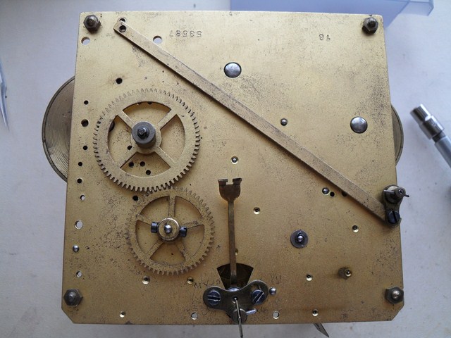

Leslie A. TaskerFirst clock

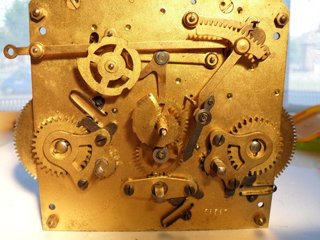

Hello, I am just starting out on clocks, I saw this clock in the charity shop and thought it would be a good one to start on when I took the movement out I sort of changed my mind if any one could I/D this for me and suggest a book I Would be very happy, the chimes are ok, I suspect the trouble is in the escapement it seems a bit twisted, there is no name on the movement but the numbers 16 and at the bottom 58587 any help greatly appreciated, I have the clock course from Tascioni,

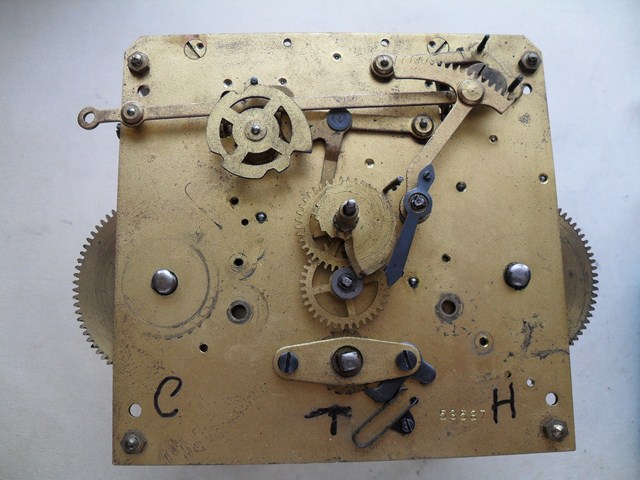

Leslie A. Taskerback

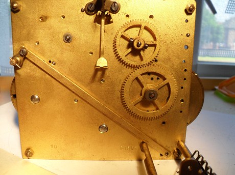

Leslie A. Taskerbottom

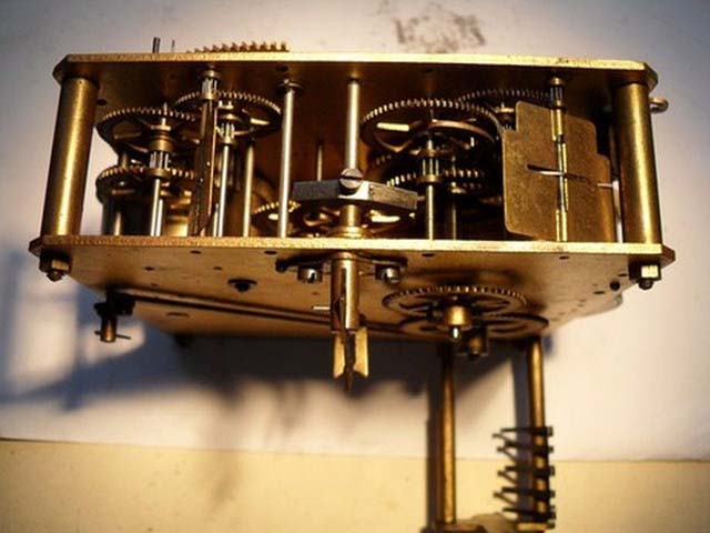

Leslie A. TaskerI think the main problem is with this escapment seems twisted

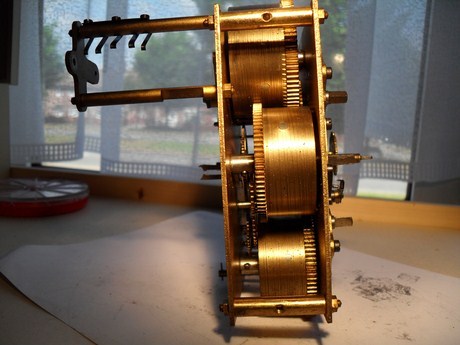

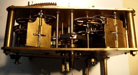

Leslie A. Taskerside view

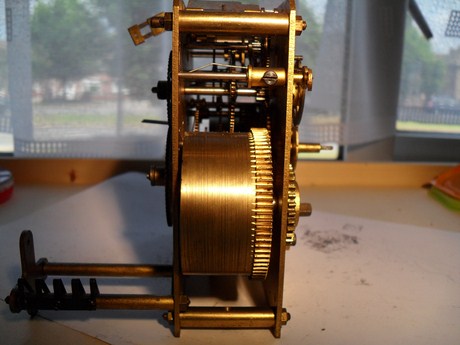

Leslie A. Taskerside view 2

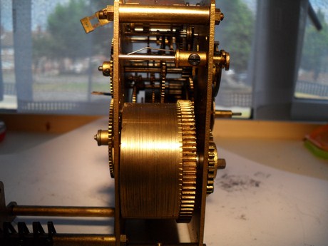

Leslie A. Taskertop view

Bill CarlsonHi, That movement looks like a nice one. But I wouldn't recommend it as a first one to repair though. It appears to have some pretty strong springs in those barrels due to the gear reducers on the arbors.
Just from the photos I think I can see that the Lantern pinion on the strike fly has some messed up leaves on it. But the rest of the movement looks nice.

John WoolseyYou certainly picked a brute for your first clock Les!
Even if it never goes again, the charity shop will have appreciated your purchase, and you'll still get valuable experience with it!
Can't tell you the make, but it's a 3x train Westminster chimer!
(looking from the front) Centre train for time, Left train for the Westminster chimes and Right for the hour count.
All the chime drum and gubbins are missing though!
Keeping it simple, what you have there is 3x clocks in one, except only one has an escapement, so nothing to be afraid of except the mother of all pile of bits when it's totally dismembered!!
Take plenty of photo's before gutting it too, and keep each pile of train parts in their own heap, or you'll be scratching your head for hours figuring out what goes where.!
Those mainsprings pack a h*ll of a punch too, so if intending to strip it down, for Gawd's sake (plus to keep the air clean and fingers intact) let down the springs First and properly rather than just 'flipping' the ratchet clicks!
If you have a key, I'd recommend cutting a slot into a round door knob or decent diameter chunk of wood and slot the handle into that - that way you can control the unwinding while you hold off the click.
And, Don't even think about using a bit of broom handle to hold the key unless you're into sado masochism or have a grip like a gorilla - you'll char grill the palms of your hands from friction burns as it whips around in your hand!
If you don't have a key, jam the thing in a vise and use a brace and bit type drill handle to unwind it all - or buy a let down tool!!

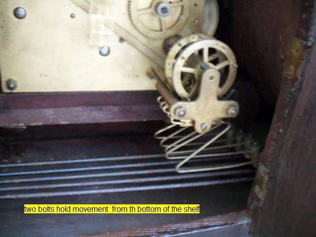

July 01, 2010, 05:30

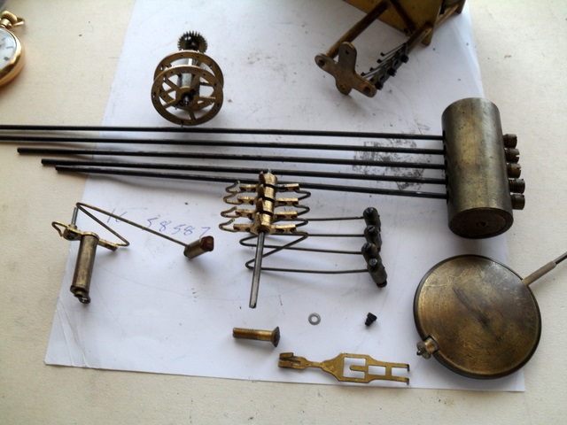

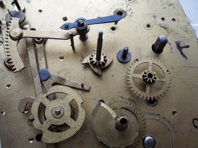

Leslie A. TaskerHi John I think these are the bits & bobs you said where missing, I took them out to get to the two great bolts that where holding the movement to the shelf which is an inch thick inside the case,Photo #2 I have ordered a multi letdown key but will keep them for somthing smaller for the time being,

Leslie A. Taskerbits

John WoolseyLes, we'd have grown webbed feet and gone deaf if the rain and thunderstorms had continued much longer, no floods fortunately, just well washed roads and a Very lush garden!
Good to see all the bits appear to be there for the clock, I'd give it a shot if getting kitted up with tools, and the let down tools are a good investment!

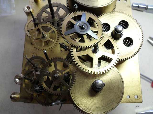

Leslie A. TaskerDecided to take the bull by the horns and have a go,
needs a good clean, just ordered some cleaning fluid that has no smell and is environmentally friendly,?
so may be seeking help shortly Regards Les

John WoolseyThe way to go Les!
Be methodical and tidy and you'll be ok.
When you get the whole thing in bits, check the pivots and bushings for obvious signs of wear first.
Work on a single train at a time, placing individual wheels in their respective holes between both plates, then lift the arbors up, down and sideways to see how much slop there is.
Clean the pivots and holes first though, otherwise you could be fooled into thinking they're ok, when it's just crud and dried oil filling the hole up!
