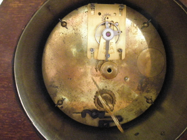

Just got nice small mantle clock made by Mappin
and Webb made in France can some one help me out with the year looks to be 8 days movement.
clock measure 12 inches long and 6 inches tall
March 20, 2013, 14:15
Peter Kaszubskiand the back side
i like the open escape wheel on it.
March 20, 2013, 17:11
Tom Bruntonthat's Mappin and Webb ,Peter , an upscale British jewelers chain
March 20, 2013, 19:02
Peter Kaszubskithats why I pick this clock.
looks to be 1950/60 production?
March 21, 2013, 10:53
Gerald ZimmermannWith those pinned plates I would date the clock earlier, the plateau seems to be a later repair/replacement.
Gerald
- no clock-man, just thinking
March 22, 2013, 15:33
Norman MayberryHi Peter,Your clock probably dates to late 1800's or early 1900's.The platform escapement made them run in any position,They don't have to sit level like a pendulum clock.The slots in the platform are so you can adjust the depth of the escape pinion into the contrate wheel.There is a pinion on the bottom of the escape wheel that meshes with the contrate wheel thus driving the train.Many of these types of clock were used in staterooms aboard Cruise ships.I've had and worked on a lot of these type of French clock.Regards.Norm
March 22, 2013, 15:50
Peter Kaszubskiwow great to know and thanks
clock run slow about 4 minutes so cleaning and oiling is a must.
and looks to be 8 days clock please correct me if Im
wrong
March 23, 2013, 08:08
Norman MayberryHi Peter,Your clock should run 7 or 8 days.I notice the regulator is set towards 'Retard".Could be why it runs slow.Norm
March 23, 2013, 14:28
Peter KaszubskiThanks I did not notice that will adjust and let you know if got better time.
March 26, 2013, 00:30
Peter Kaszubskiafter some adjustment it is running good now.
