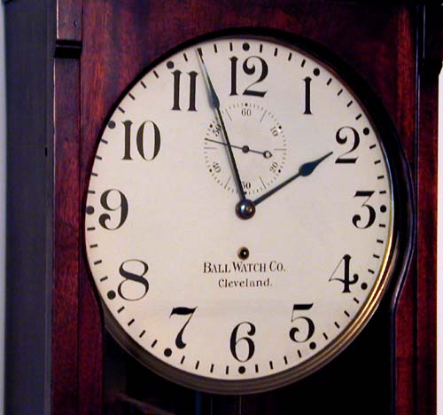

William is entirely correct, anyone can have a "Seth Thomas" or other dial redone to say "Ball Watch Company" and thereby fool the unsuspecting. That being said, the one in the auction has "the look" of being the correct dial and hands, similar to those found on some "Official RR Standard" Ball Watches. Unfortunately the dial is somewhat faded as if it were exposed to sunlight or having been "over-cleaned" at some point.

Some questions are in order here, so I wrote to the seller and I'll let you all know if we receive a response. I'd also venture the clock in the auction is somewhat older than the seller believes. Perhaps some of this and the 14" diameter dial in the picture below will be of help those considering such a purchase.
This "Ball Watch Company" Regulator once timed the Erie Railroad... September 15, 2003, 19:35
William MittelstadtLindell is a little more optimistic than I. This "Ball Regulator" is in essenace a more common Seth Thomas school house clock with which if you change dial, you more than double it's worth. All bogus clocks and watches are made to look correct and unsuspecting. That is the seller's objective to deceive. This is the reason to do your "homework" and investigate before spending your hard earned money. This clock may very well be 100% correct but besure before you bid. It is far better to over spend on a geniune specimen that get a deal on a fake. All I am saying if it dosen't have the provedence of a correct label it is far better to wait and get one with the right label even if it costs more. We all know the example of an expensive clock or watch and it is one you can't sell. William Mittelstadt
