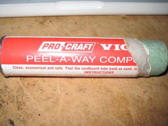

Ray HallenbeckHi Dana,  I like to buff or polish my Stainless cases when they get to scratched.
 I use this with my polishing wheel.  Go to the Vigor site and you can check out which one might work best for you.  For stainless I believe it's the White, Yellow and Green compounds that work well.

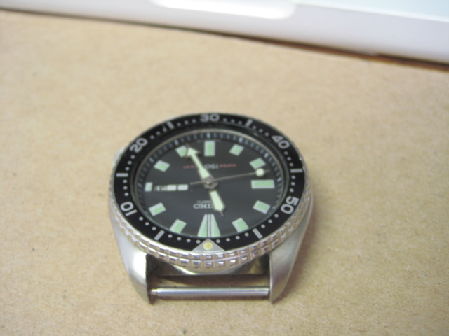

Ray HallenbeckSometimes, I will use the sandpaper to sand out the scratches and leave the top portion of the case with the sanded (almost frosted look) and polish the sides of the case to a high shine.  Gives it a nice two-toned look.

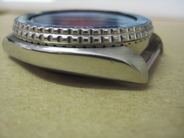

February 23, 2012, 16:07
Ray HallenbeckYou might be able to see the contrast between the polish/sanded parts in this picture a bit better

Dana FullerYou do nice work, Ray.  Thanks for all that information.
