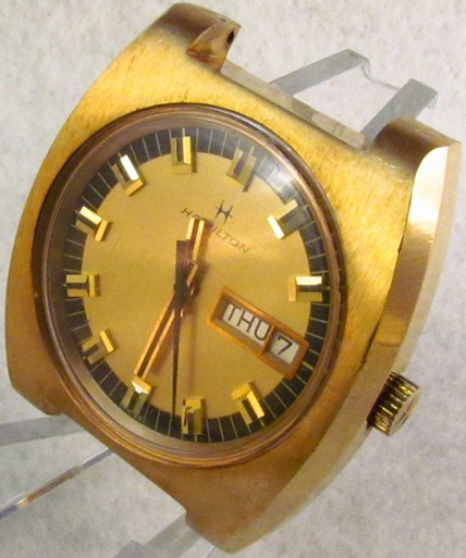

Harry J. Hyaduck Sr.I need help on a Hamilton Wristwatch ID.
I can not find this wristwatch in the Price Guide. I would like to sell it but I need some information before I put it on the Bay. Does anyone know the model number or how many jewels or whether or not if it is battery or mechanical? I don't have anything to open the back with but it looks like from all the scratches whoever owned it before me did not have anything to open it with either. It is a big heavy gold electroplated watch.
Thanks

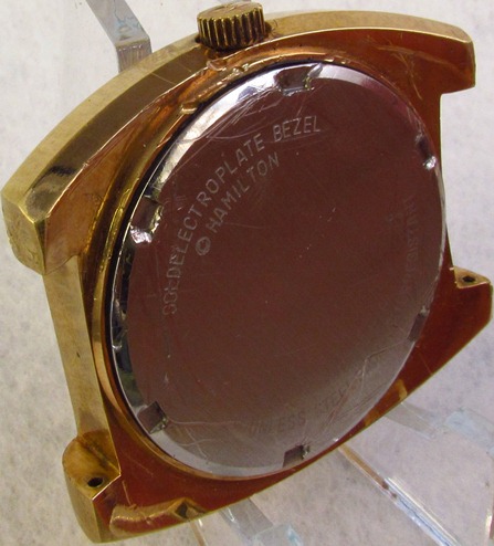

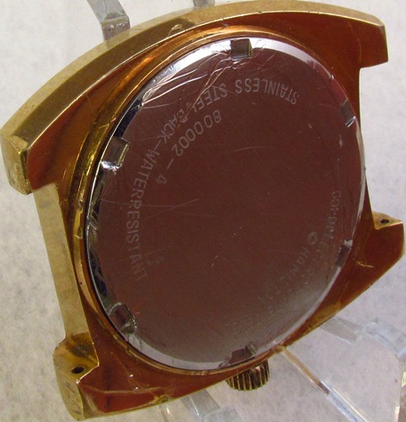

Peter Kaszubskihow about the back case picture.
Also try crazy glue with hex nut to remove (unscrew)
December 27, 2011, 21:19
Peter Kaszubskiis the watch running?
December 27, 2011, 22:14
Harry J. Hyaduck Sr.No the watch is not running. It could need a battery if it is battery powered. I will try the crazy glue and let you know.
December 27, 2011, 22:20
Harry J. Hyaduck Sr.Another of the back.

Ernest C. BarnesHarry, I would say it has an mechanical movement, 17 jewels, either an ETA or A. Schild movement. If it were a Electric Hamilton it would be marked on the dial.
December 28, 2011, 12:28
Harry J. Hyaduck Sr.Thank you Ernest. That helps. I still can not get the back off. I will try Peters superglue suggestion.

December 28, 2011, 20:32
Harry J. Hyaduck Sr.WHOOO HOOO! I FINALLY GOT THE BACK OFF! PETER THANK YOU FOR THE SUPER GLUE IDEA. HOWEVER THE NUT KEPT SNAPPING OFF. NOT ENOUGH SURFACE AREA TO HOLD. SO I GOT A PIECE OF FLAT STEEL AND THAT DID THE TRICK. SORRY ABOUT ALL CAPS BUT I DID NOT REALIZE THEY WERE ON.
The watch is now running and keeping good time. The roller jewel had jumped out of the pallet fork. I put it back in and it took off. It is a HAMILTON 801 with a gold electroplated case but no strap. I can not find a value for it in the price guide. Does anyone know how I can find out it's worth. I am not trying to get everything I can for it. A member wants to buy it and all I want is for both of us to be happy. Any suggestions?

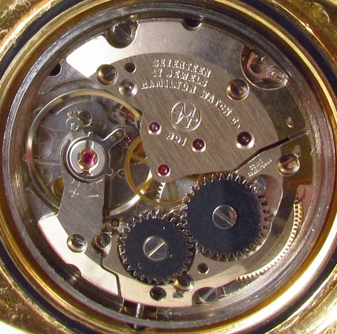

Peter KaszubskiHarry the idea is not mine I found it on IHC185
can you post picture of the movement.
December 29, 2011, 12:59
Harry J. Hyaduck Sr.Here you go Peter. You may not have come up with the idea but you planted the seed. It has been running for about 18 hours and it is keeping perfect time with my quartz wristwatch. The date/day is working as it should also. Thanks.
